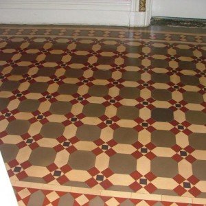

Belfast 1 Mosaic floor in Belfast Harbour most of the floor sections had lifted in a typical dome fashion. we used a pressure gun to inject an ardex adhesive under the affected areas we re-fixed approx 40-50 sq mtres a day. beating any other Co for time scales.
Belfast 1 Mosaic floor in Belfast Harbour most of the floor sections had lifted in a typical dome fashion. we used a pressure gun to inject an ardex adhesive under the affected areas we re-fixed approx 40-50 sq mtres a day. beating any other Co for time scales. | Tiling Advice | TilersForums.com | Images & Downloads - TilersForums.com
  • Tenchman
Excellent work

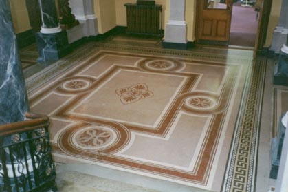

Thanks ! this is part of 500 sq metres we restored in under a fortnight, most of the floor was loose we injected through holes made in the mosaic by taking out tiles.
Another firm had taken 6 months fixing less than 20 sq metres. we are just more experienced and know some good wrinkles.
