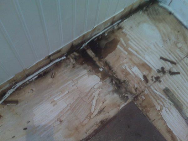

Francis Rd, before and after. Previous tiler had over boarded floor with 4 mm ply and fixed with 25mm clout nails, and used non flexy adhesive with no porcelbond for porcelain tiles.
