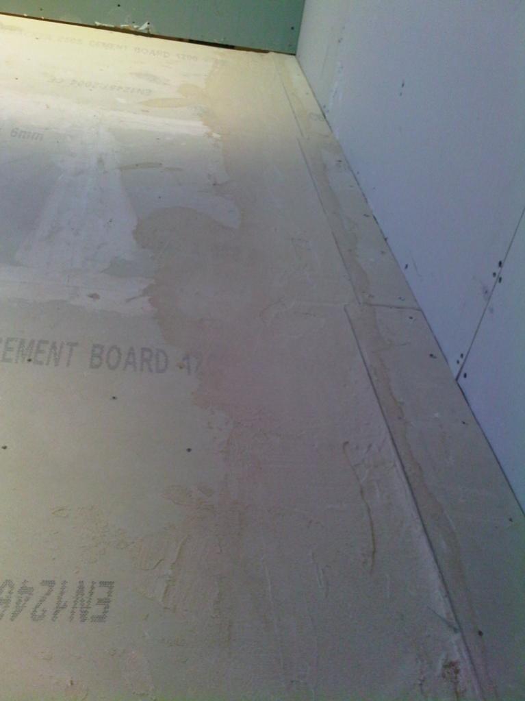

Master EnSuite - 120mm strip of HBB fixed with adhesive and screws (as with other boards) along the lowest side of the floor to make up the additional 8mm needed to level the floor. This will act as a runner for installing the levelling compound.
