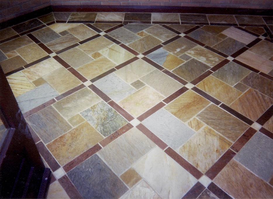

Doug - You can cut this design from any tiles but in this case it is :
1) 250x200mm Oyster stone with a 50mm taco inset cut from Oyster stone.
2) Hand cut strips of Honed copper slate approx 35x225mm with a 35x35mm taco inset cut from Oyster stone. (have also done this design with a honed green slate!)
What I liked with this design, and the 3 times I've done it has been in conservatoies, is that the light shines off the different materials.
Pleased that you like it and feel free to use it.
Just ring if you need any further info.
