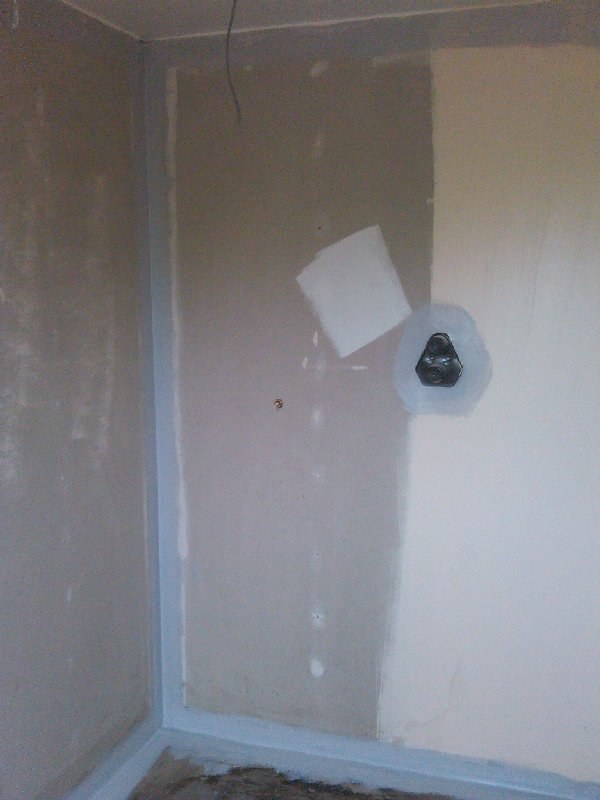

This is taken after all the Mapeband has been bedded into the first coating and then given a second coating with the Mapegum and paint brush over the Mapeband. Note that I have also cut in along the ceiling level and around the shower valve with the paint brush, just to make sure i don't need to go to near to the painted ceiling and valve with the roller.
