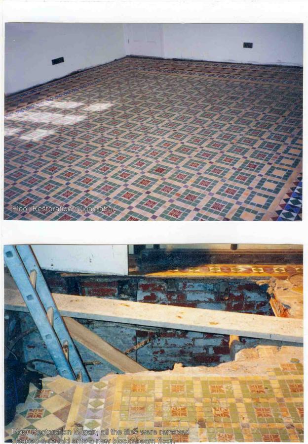

Wigan Floor this floor was dropped into the cellar below all the joists had rotted. we used a new beam & block floor and screeded with Tilcon fibre screed. cleaned the thousands of tiles and re-fitted them.

The top pic is the floor restored, bottom pic is how we first saw it we dropped the whole floor and then laid new concrete beam & block floor( you can see the floor was badly damaged = all joists had dry rot ) new Tilcon screed with fibre-glass was laid over the beam & block then the thousands of 2"x2" tiles that we rescued from the drop into the cellar had to be cleaned = edges & backs of mortar before being re-laid as in top pic.
