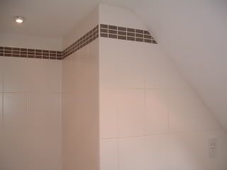

Hi guys,
Just finished an ensuite on a new build. This place was huge and the owners are very tile happy. Got the job when the original tiler got the hump with the site boss and chucked a bucket of grout water over him :lol:
Here's a few piccies:

I'm the first to admit a fluke but that shaver socket was intentional goddamnit!!
I guess that's a prime example of why I take so long - not many people would bother to take the time to set out the wall for that nice cut and I'm sure only another tiler like yourself would notice and appreciate it.
Just wondering if I'm being too anal about detail or that I am just naturally a slow tiler.
Mick - keep them speedy tiler tips coming, love that thread!
