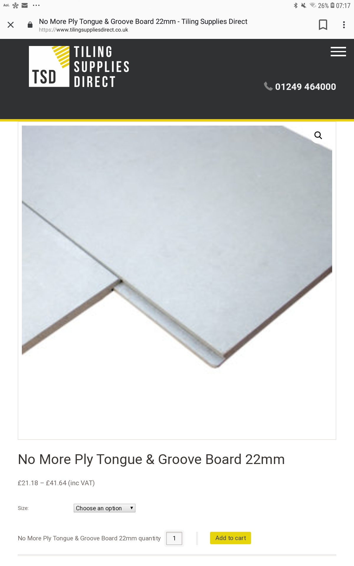

As above 22mm No more ply is a tongue and grooved tile backer cement board . Kop
