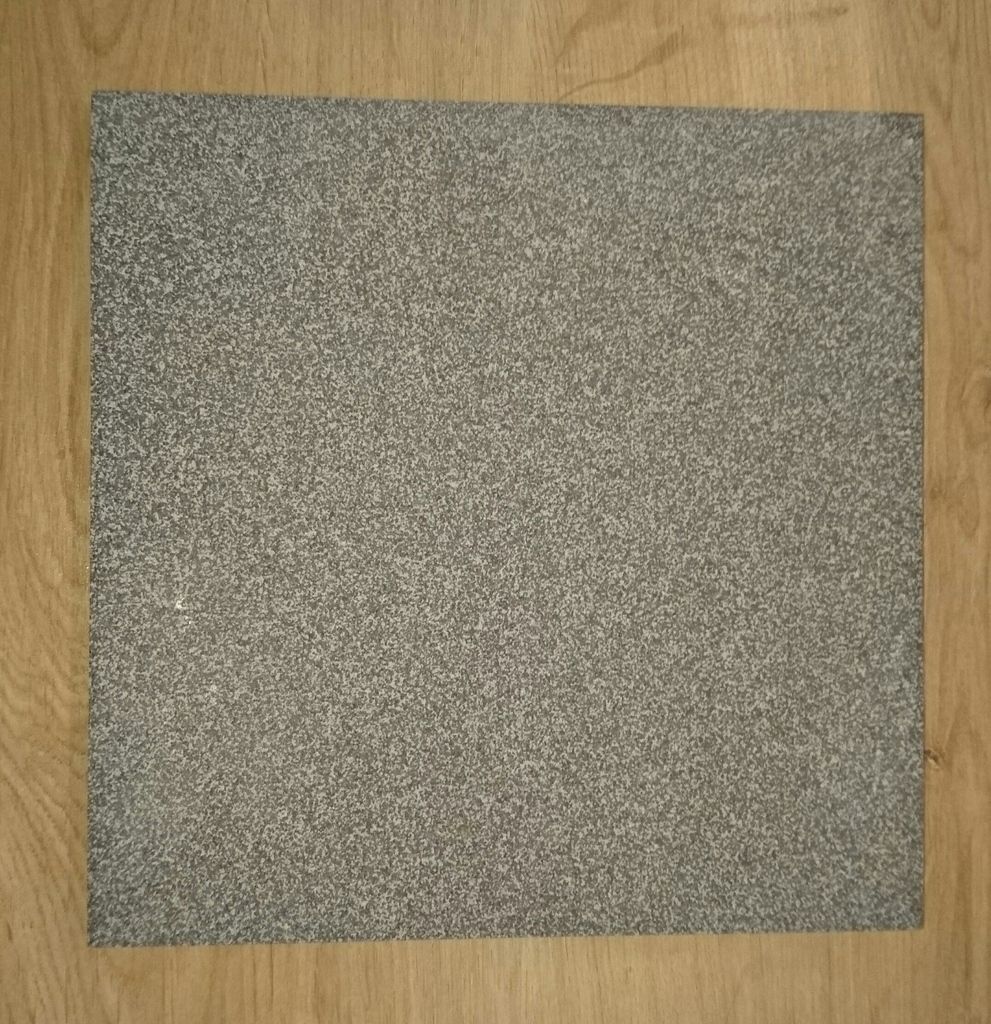

Can any experts give me some advice please. I have a single brick detached garage which I'm going to tile out with porcelain floor tiles ( 200x200 casalgrande padana granitogres technic 11.3mm thick).

Hello Stu, for a few reasons I would advise levelling the floor and fitting Schluter Ditra 25 then tile. Your within the limits so need for an expansion joint in the tile bay. The Ditra will really help with the contraction and exspansion that will occur with this floor. I wouldn't be too concerned about the joints in the substrate that I can see from the pictures if you use Ditra. As it's a garage are you really concerned about the joints staining if not UCP grout would be fine.
