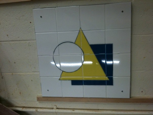

The only other time I have done this was at college, but instead of using different coloured grouts I used white and black grout and used blue and yellow food colouring to make yellow & blue grout......only because of shortages of different coloured grouts in the classroom. Anyway it bled as you can imagine & don't want this actual job to do the same lol, iv included a picture of my college experiment for your entertainment see below
