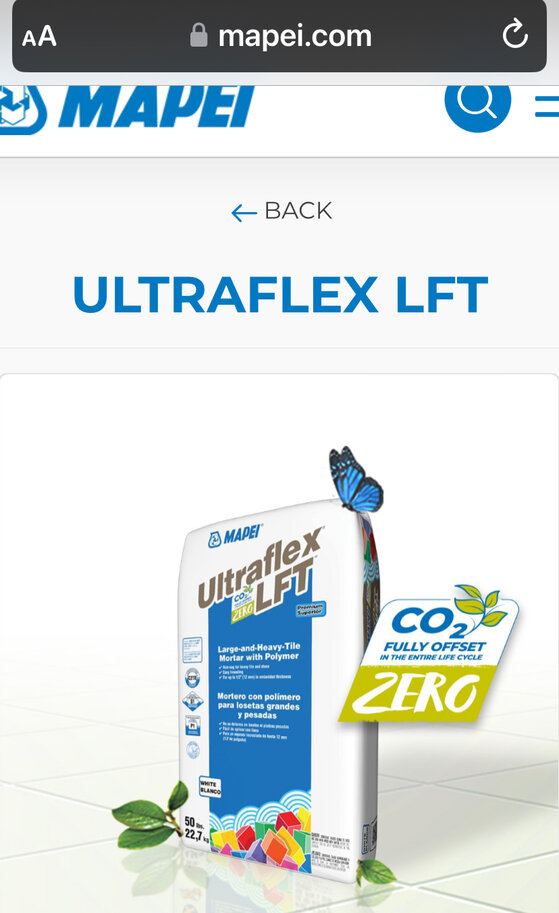

Hi, I need an adhesive suitable for 20x20cm cement encaustic tiles on unskimmed plasterboard please, I found this mapei ultraflex lft recommended in several places but can’t source in uk, what is widely available that is like it ?
Thanks

It doesn’t, we also live on a remote island so I need to order it in, but I don’t know the name of a similar adhesive and there’s no stockists of the specific Mapei adhesive I mentioned in the uk. Any suggestions of similar? Thanks for replying.

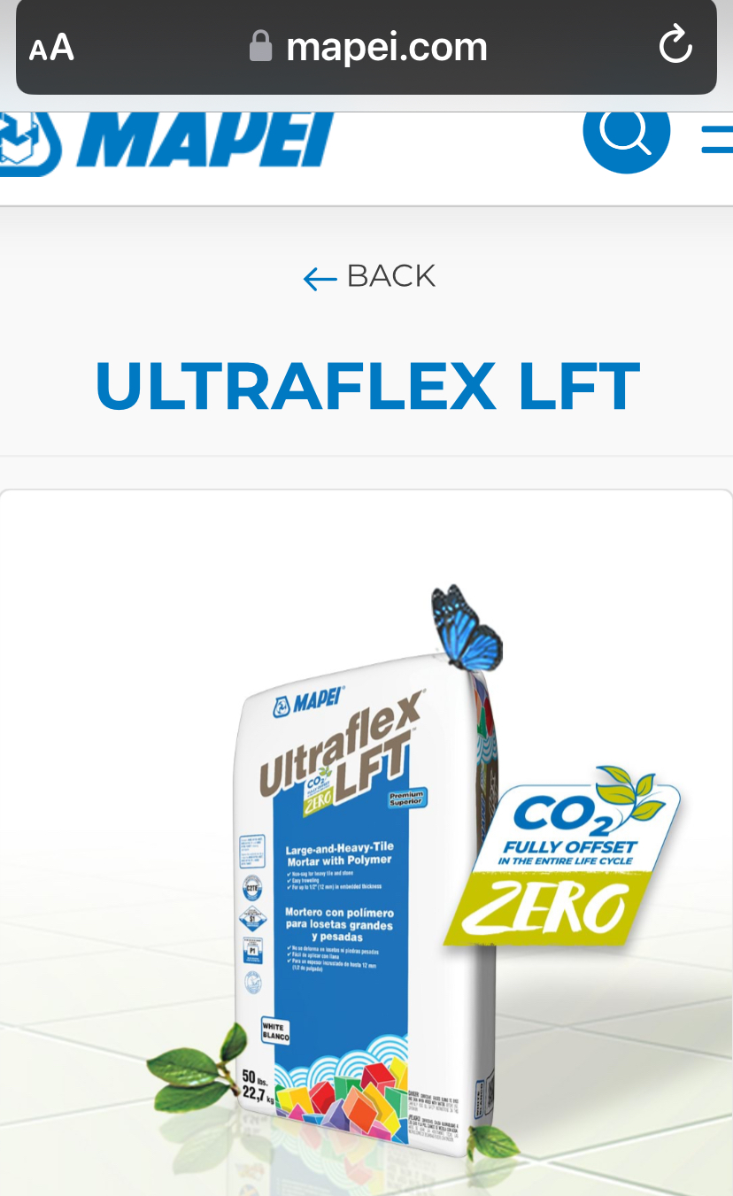

Thanks Dan, I can get several different Mapei adhesives but I can’t source that particular one that’s recommended for my heavy tiles anywhere in the uk, perhaps it’s called something else here? Or I’m after a suggestion of something similar key words being ‘heavy tile mortar with polymer’ I guess?
We also live on a remote island so I need to order it in by boat!

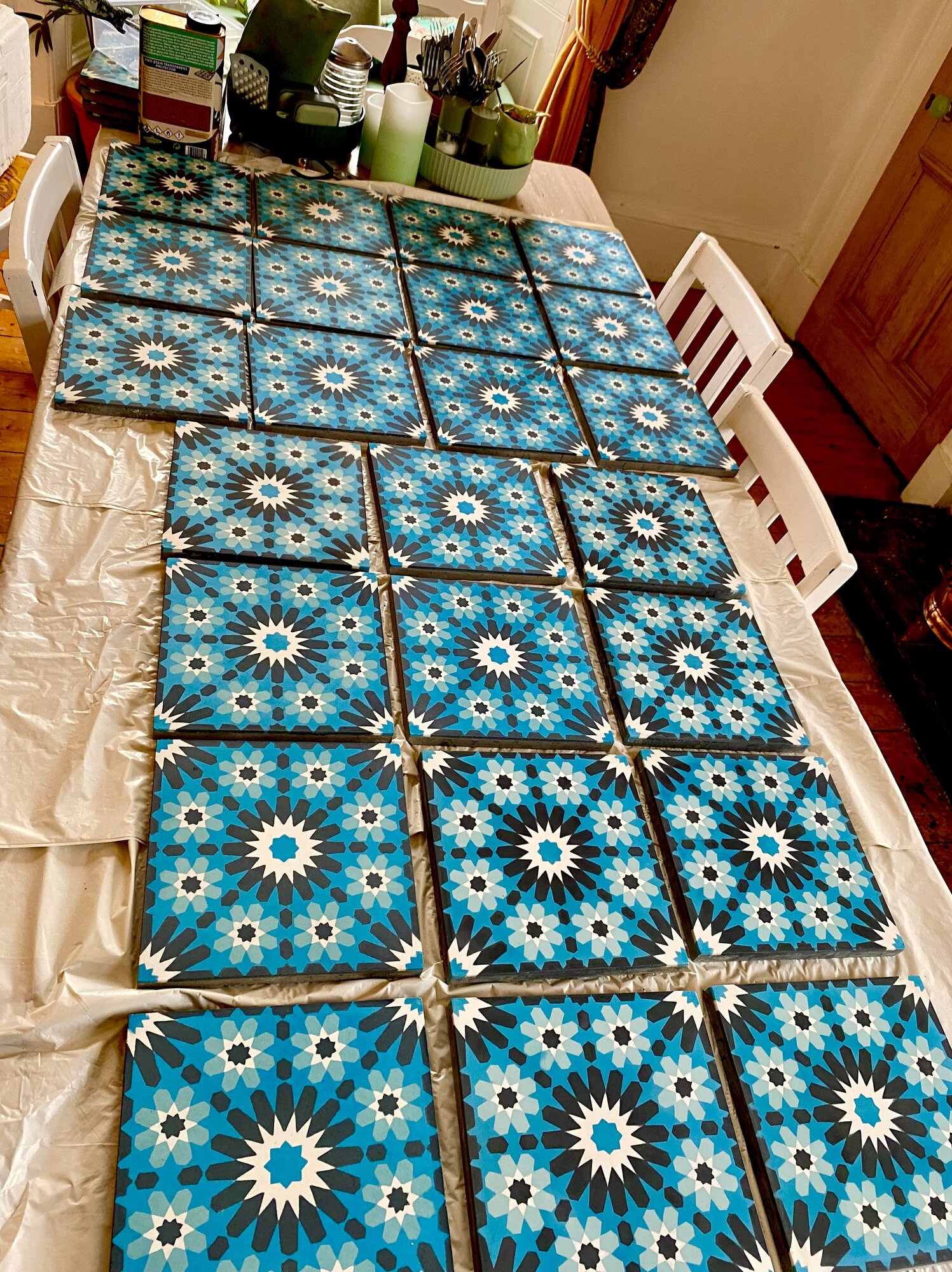

Just a couple of rows of tiles but these bad boys are hefty!

Also maybe mix it thick-ish, just a half a cup less water. Small amounts at a time, even 2 tiles a time and get those spot on before mixing more. Doesn't really matter how heavy they are the suction should keep it steady.
Failing that use two thin wooden boards either side and trap the tiles and adhesive in place.

You just need to hammer a couple of nails level under the first row to keep them there.
Fast setting stuff. Shouldn't need it thicker (as in stiffer, not adhesive depth). For walls at least.
Got a picture of where it's going? Is that built yet. Sorry if you've said it already.

Great advice Thankyou!
