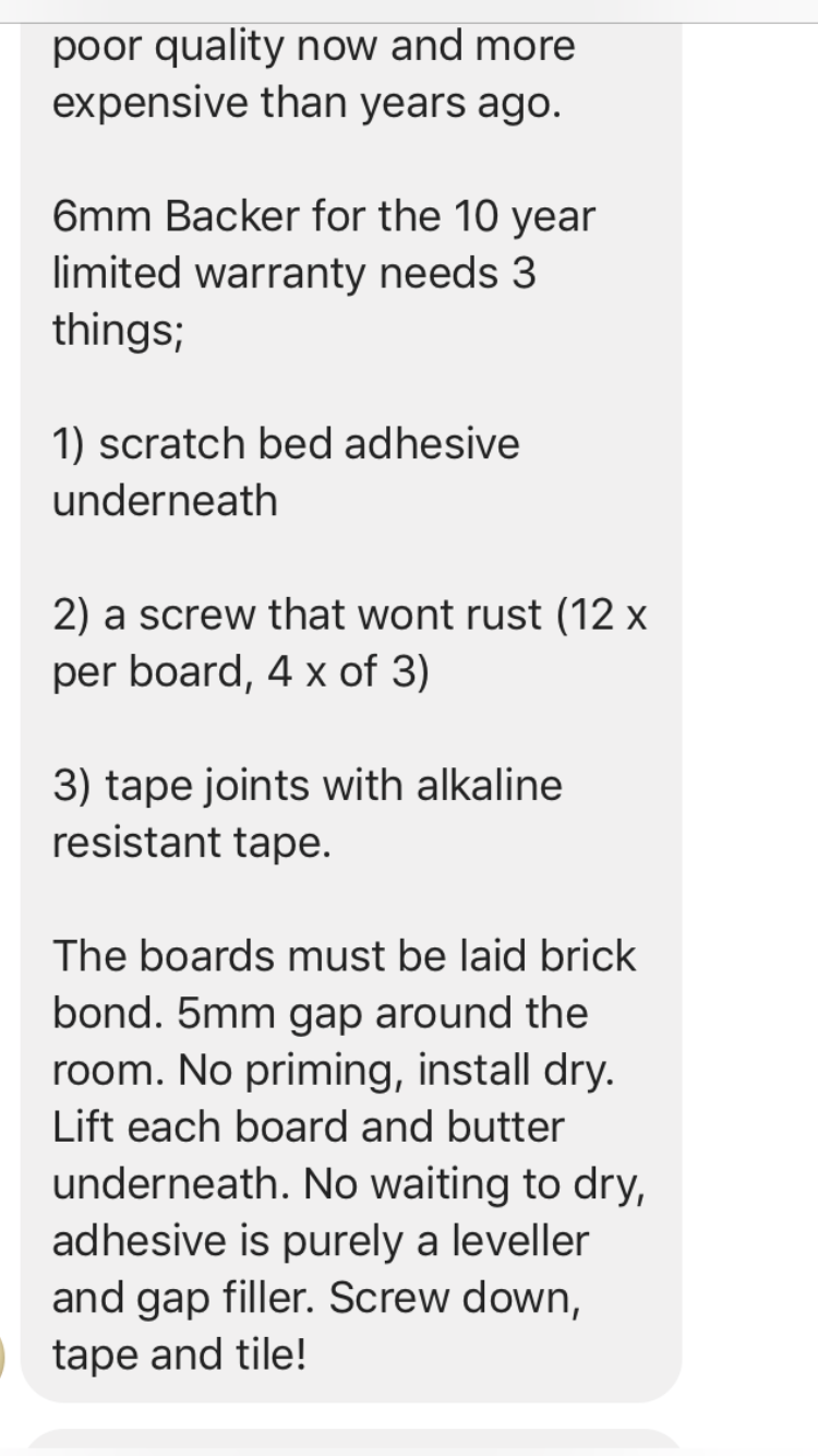

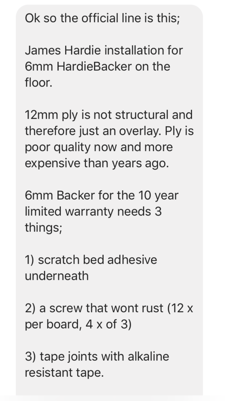

Hi all, I got a screen shot of advice from a hardie Rep which might help out.
87AAD59B-6F40-4468-ACA5-EE81FC05B99D.png AA467A43-506F-4237-B2F3-BDD74B1B64E9.png
Dumbo
Thanks for taking the time to reply guys. I'll be doing the adhesive, screw and tape method.
