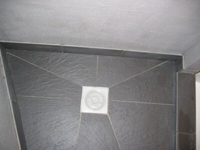

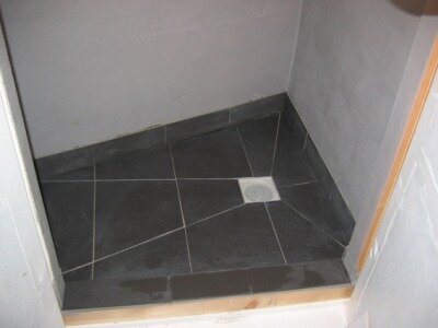

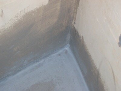

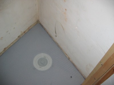

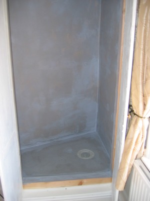

Attached are some piccies. Note that the final grout is not in place on any of these. They just show the tanking taking shape.
I'll take one of the finished grouted floor and add that later.
