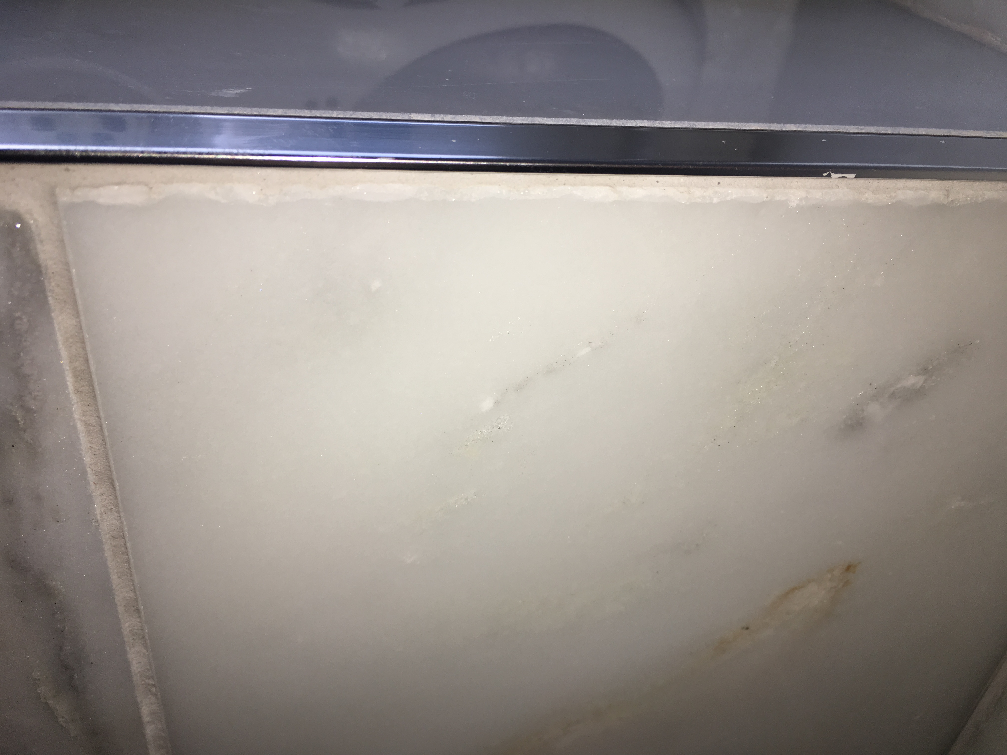

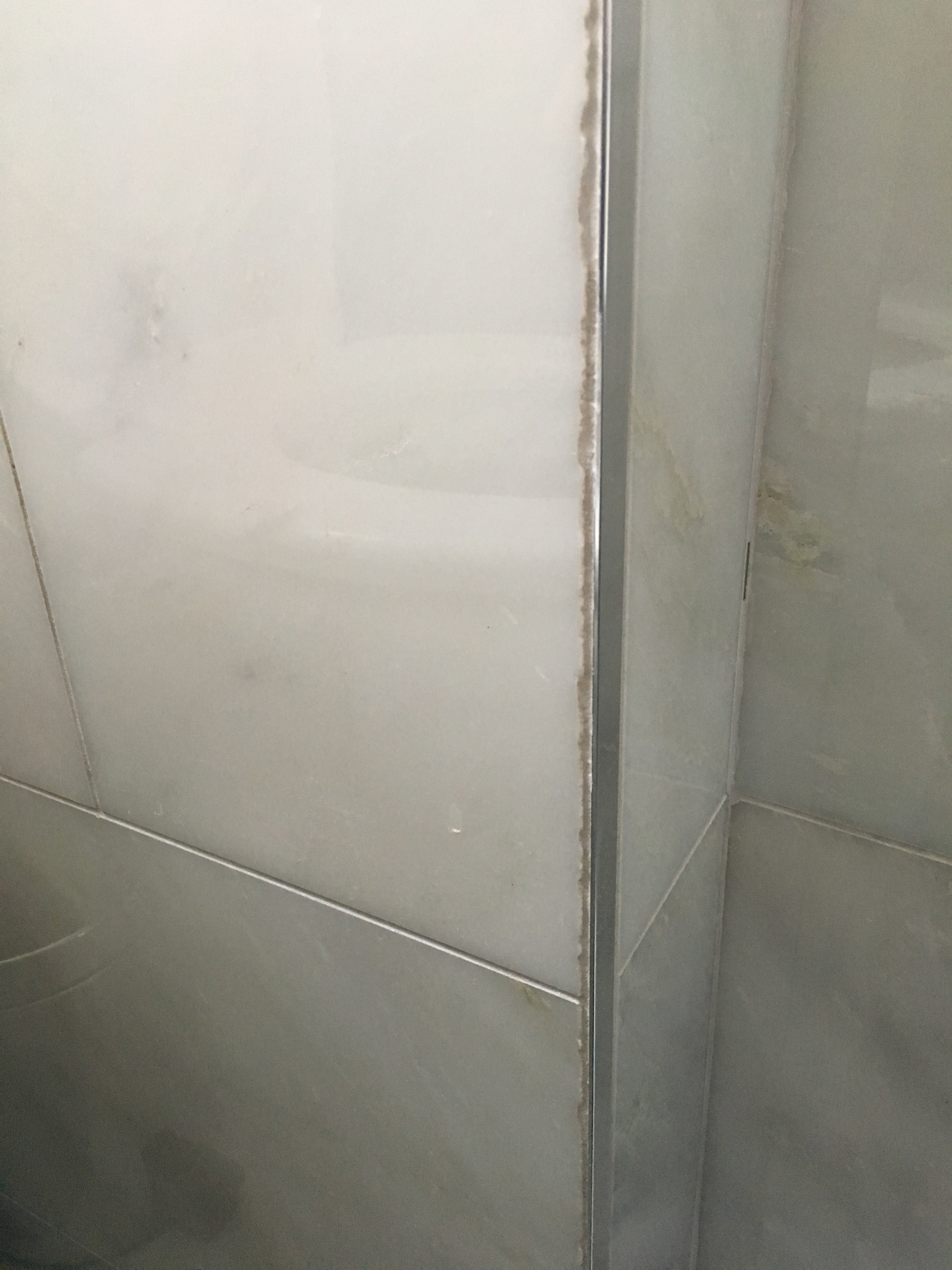

I have recently had my bathroom done and I wanted to get some advice about the finish of the tiles. I ended up going with marble tiles on the basis I won’t get my bathroom done again anytime soon.
Unfortunately, some of the tiles look pretty jagged/uneven where they have been cut. I’m not sure what is realistic to expect with marble tiles but they were relatively expensive so grateful for any advice on whether this is usual! Examples below.

It is poorly finished, it’s either laziness or inexperience, either way you should expect a much higher quality of finish.
Have the tiles changed in colour or appearance?
I’m not certain, but I don’t think so - some of them are more yellow toned than others but I think that’s just natural variation. Is there something I should be looking out for?

It’s hard to tell from images you’ve posted, they just looked a little grubby. Make sense?
Grouting doesn’t look the best and even picture framing looks present.
But could totally be just images and not a true reflection of the overall finish
They aren’t dirty if that’s what you mean? They feel jagged and sharp if you feel down the edge. Those were the best photos I could manage, but they are pictures of the bits that look the worst as that’s what I wanted views on.

Marble - even a relatively low-grade marble should NEVER have a chrome trim stuck on. It should be polished, bull-nosed or mitred/polished.
That is truly awful work.
Even IF you are happy to have a trim on the edge of stone, it should be done neatly. Whoever did that needs their vision checking.
Sorry - I feel for you, but we see this every single week....
