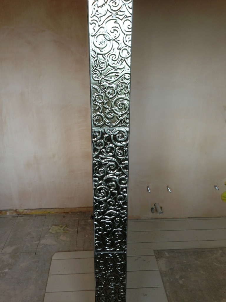

I've recently done this Doug, and I voiced my concerns to the plumber at the time, asking if it would be fixed down. He said it would be screwed down to the substrate, in these pics you can see the beginning of the install that had to be put in under the stud wall

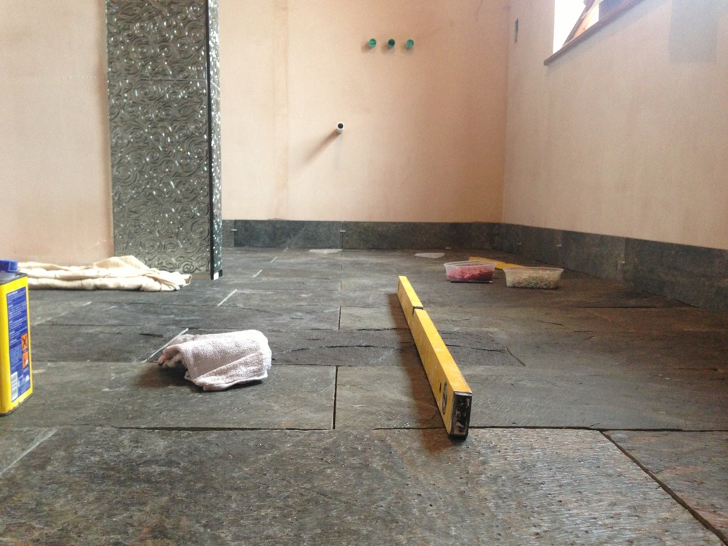

With the rest of the floor I asked for the boards to be glued and screwed, as would be done with cement board, it provided a deflection free substrate that I was happy to tile to, here is a pic of the floor 90% complete
Still not finished yet, still some skirtings and finishing to do. This is porcelanosa slate.
