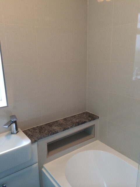

Thank you for your suggestions. I have 'roughed' it in with 2x4 treated timber, so don't have too much flexibility. I'm just trying to decide how to treat the interior - inside over the exterior, flush with the exterior or AN Other...
I also have some edging, so am in a quandry. I have some impey waterguard stuff, which I snagged off ebay, which I hope may be a stand-in. Sort of making this up as I go along!
blue_max
OK fair point, if it helps...
The tiles are the same colour (a dark grey). I shot these outside, so they look totally different, but hope you get the idea.
www.mcreative.co.uk/tile_niche_options/1_no_trim.jpg
www.mcreative.co.uk/tile_niche_options/2_trim_to_front.jpg
www.mcreative.co.uk/tile_niche_options/3_trim_on_top.jpg
From a waterproofing point of view, having a full tile on the bottom would be best, but If it is waterproofed well, I might not be too concerned about another option if it has a nicer look. These won't be directly under the shower. 1 shows a cocktail stick to represent grout. I will use a dark grout, but am unsure whether to use grout between the trim and tiles.
The tiles have a factory edge which is obviously unglazed, but I don't dislike. It has a more industrial look, which is fine. I also wonder about grouting into the inside edges, or just a smear of Silicon on the tile edge.
