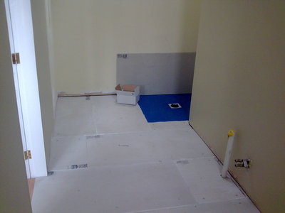

Hi all! So I got to a job yesterday downstairs wetroom floor with mains underfloor heating...
