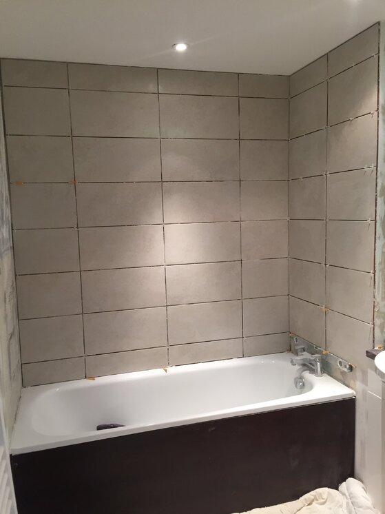

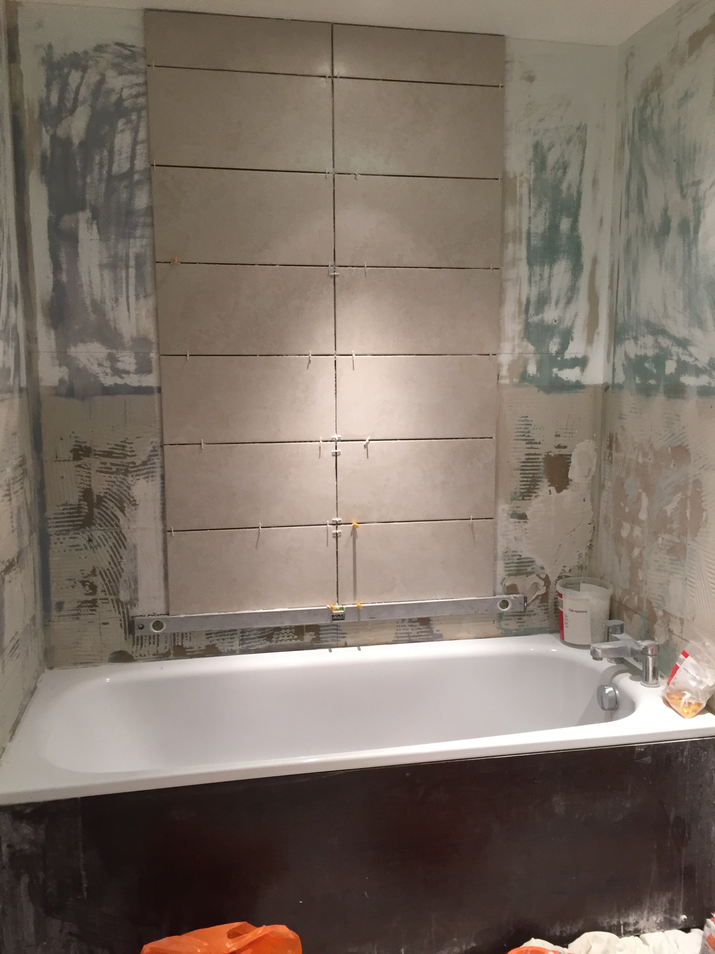

@mike1979. I def didn't dot and dab. I used a 8mm notch trowl and also buttered the tile.
I made sure to clean all the joints so there's no adhesive in there so it's full of grout only.
