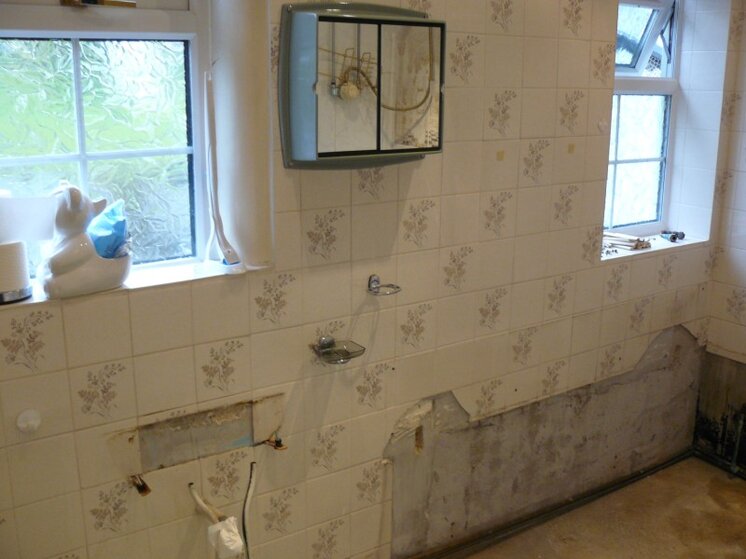

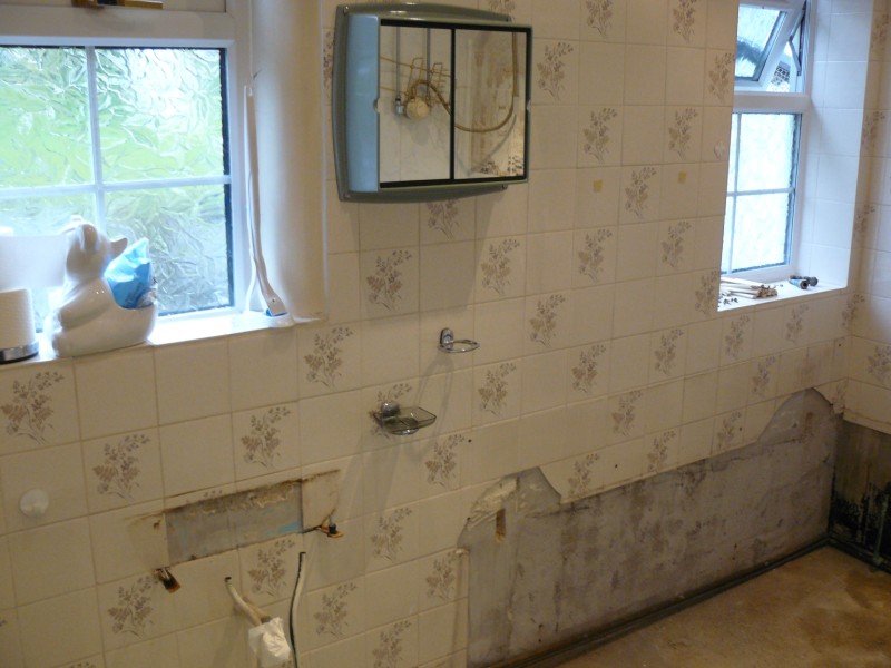

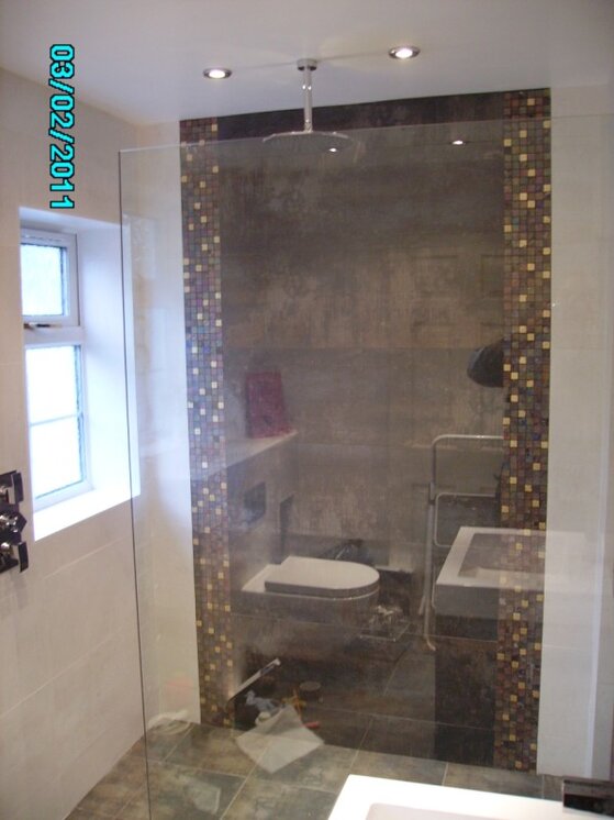

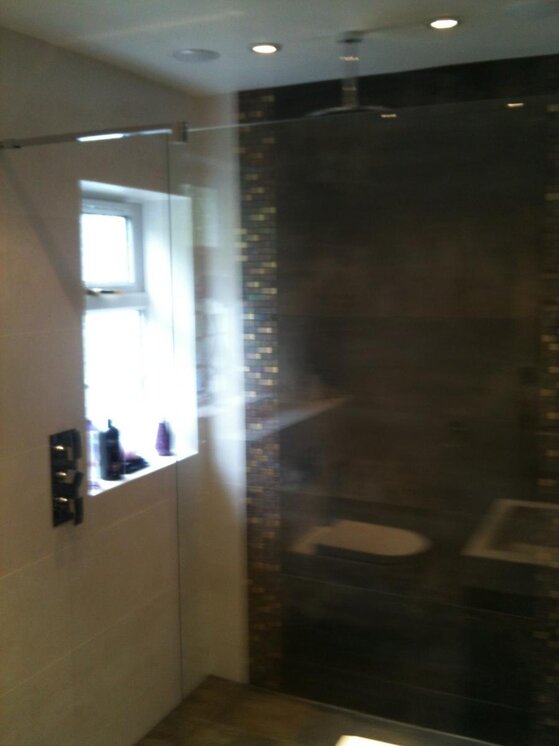

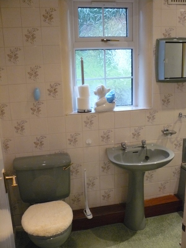

Before and After - 70's Bathroom to 00's Wetroom

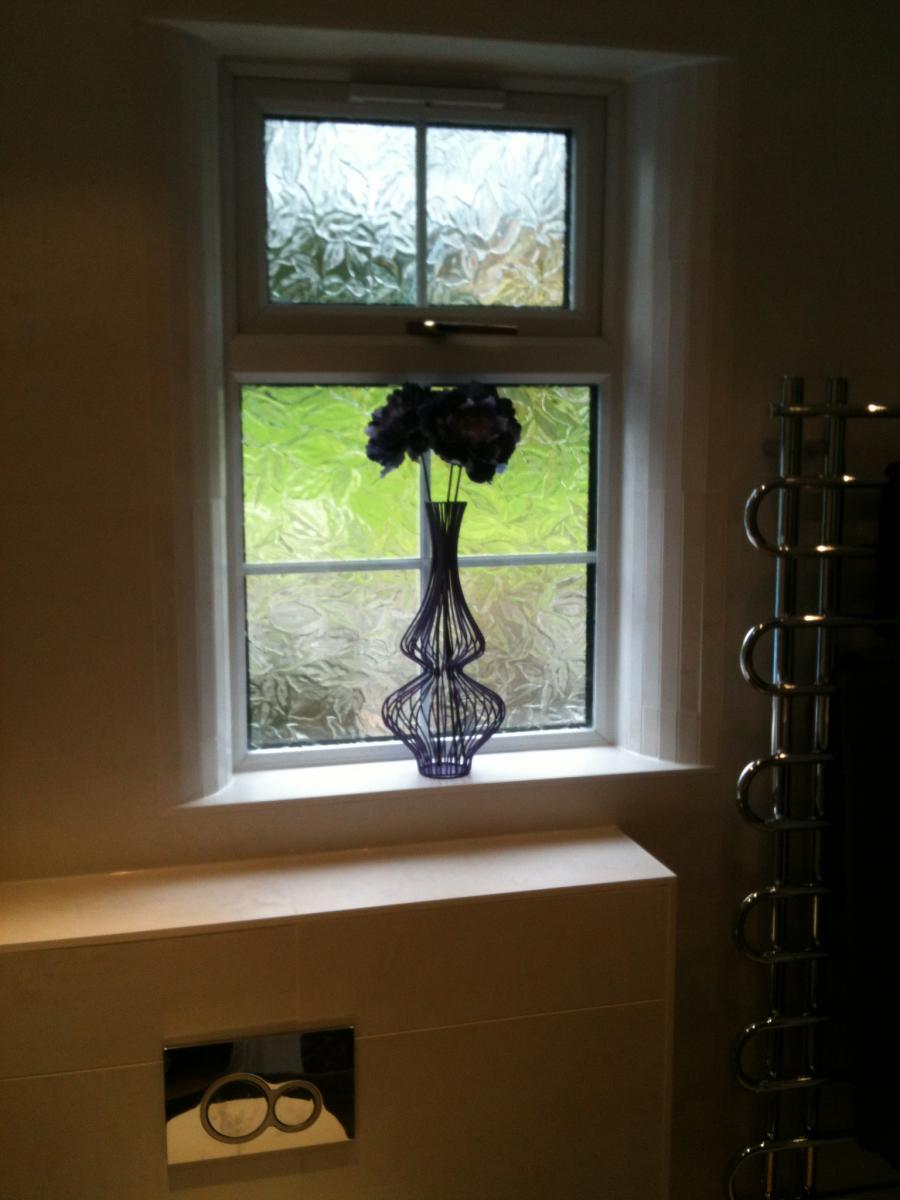

Wall Hung Loo
Shower Speakers Ipod Connection Socket in Office next door
Underfloor Heating
All Copper pipe / Waste all solvent weld
New Rad, Lowered Ceiling, Shower Controls Outside (no wet arms)
Seperate shower riser and wand in recess (where old shower was)
Humistat fan
Dimmable lights
LED Mirror
Shaver Point

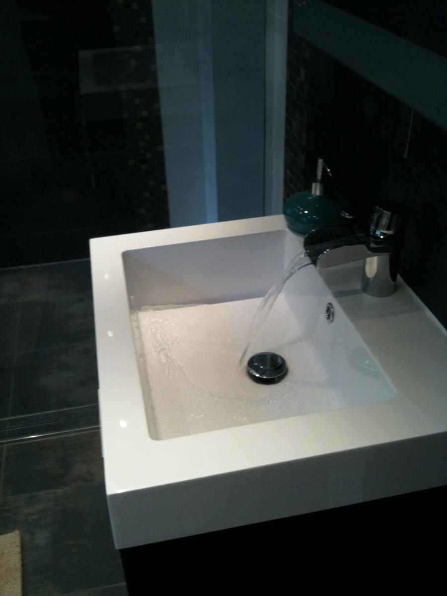

Wall hung sink with "blade"type tap
Curved Tiling to original window reveal
Purus Stainless Steel Slotted Wetroom drain

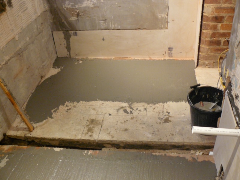

Wetroom tanked to 6' & floor fully tanked with tanked skirting around rest of bathroom
Rescreeded floor so both sides of glass fall to slot drain
P1010421.jpg P1010427.jpg P1010423.jpg P1010465.jpg PICT0131.jpg PICT0128.jpg 2012-06-12 11.01.38.jpg 2012-06-12 11.01.47.jpg 2012-06-12 11.01.12.jpg
