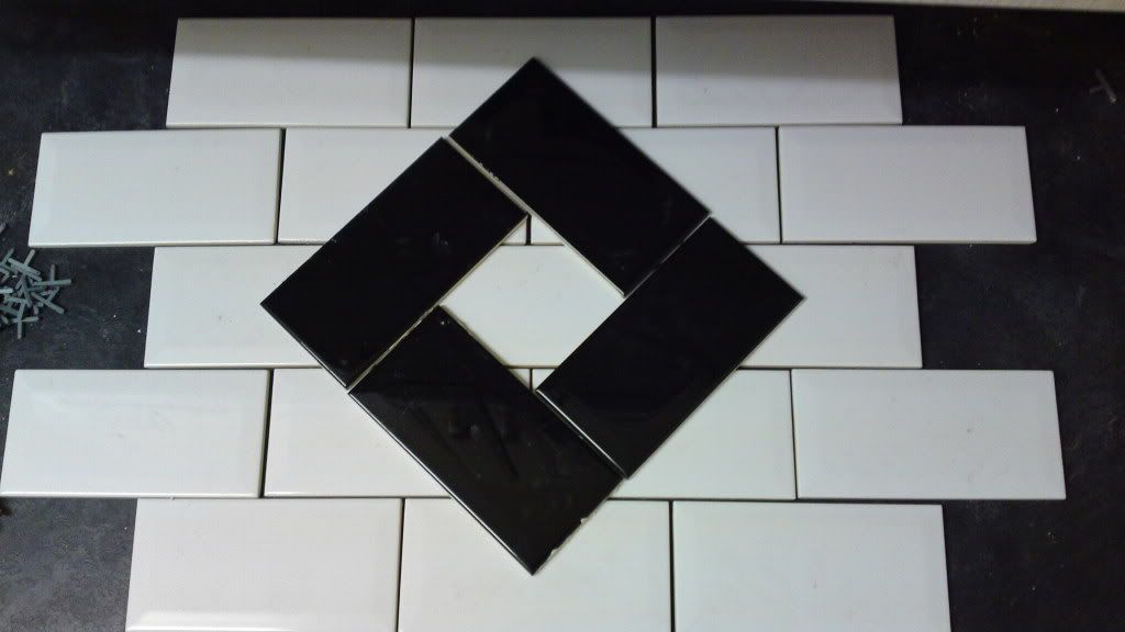

i'd like to do somethin in that area aswell, just a small feature like in this pic but am kinda worried incase it looks weird with the tiles being set brick effect. whats the general opinion on features in brick effect?
