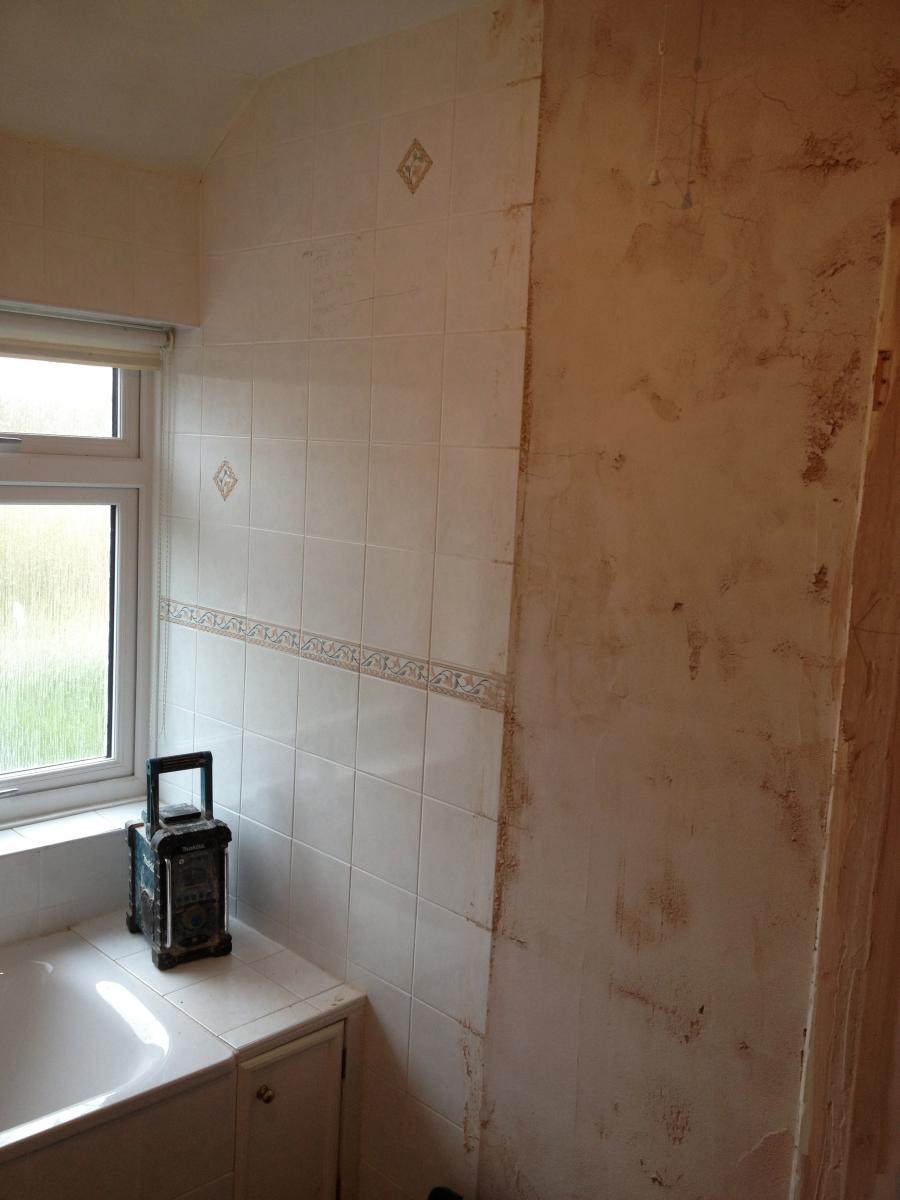

So I turns up to fit a bathroom and tile the walls...blind mind..and he present's me with a difference of 22mm where he wants me to tile over tiles and part wall..and so its 2 mm proud so he can skim up to tiles on far right,where he has left the wooden pillar in...tiles are 8mm !..don't you love em..think ill glue and screw 6mm hardi on walls to take up some slack !
