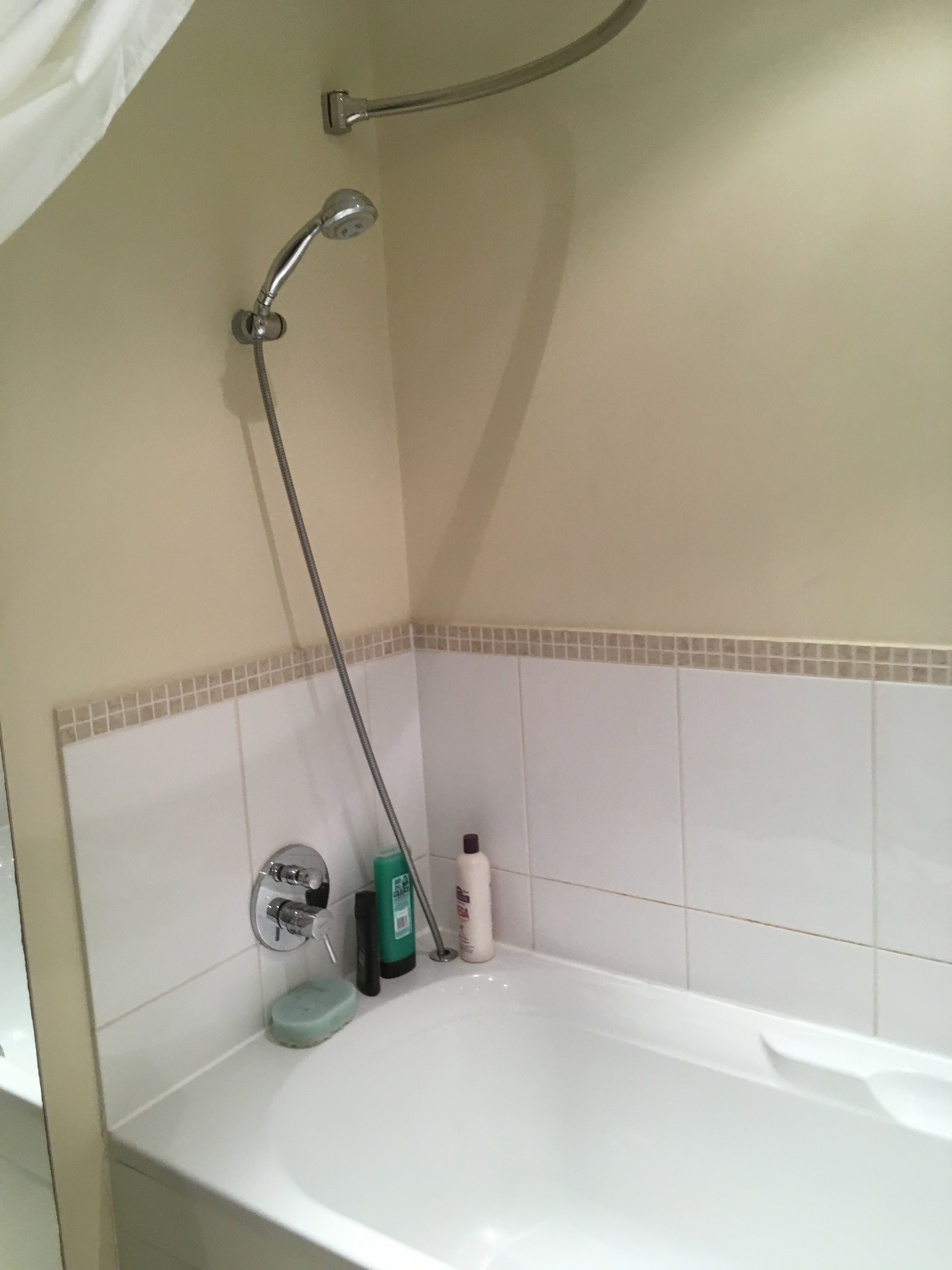

Hi everyone. I am a little stuck as to the best way forward on a job I have been asked to do. I have been asked to tile above the existing tiles to the shower area of a bath. I thought it would be simple to find bumpy white tiles 396 x 297 x 7mm, but I cannot find anything like them. I've thought of smaller ones but think they'd look weird. The larger ones I find seem to be 600mm and my cutter is 540 max I think. I'm not great with my grinder yet so wouldn't want to risk it. The area to tile is 830 high, and 740 / 840 wide. Could anyone please advise what they would do?
Any help would be much appreciated
Many thanks
Dusty

Topps do a 300 x 500 plain white which will probably turn out to be 298...
As long as you can match the width near as dam it the height doesn't really matter and the boarder and white grout should hide any discrepancies.
It's a case of making do with what is available or stripping it all off and starting again...
Thanks very much for this Andy, I missed those! Sounds like they’ll do nicely :)
