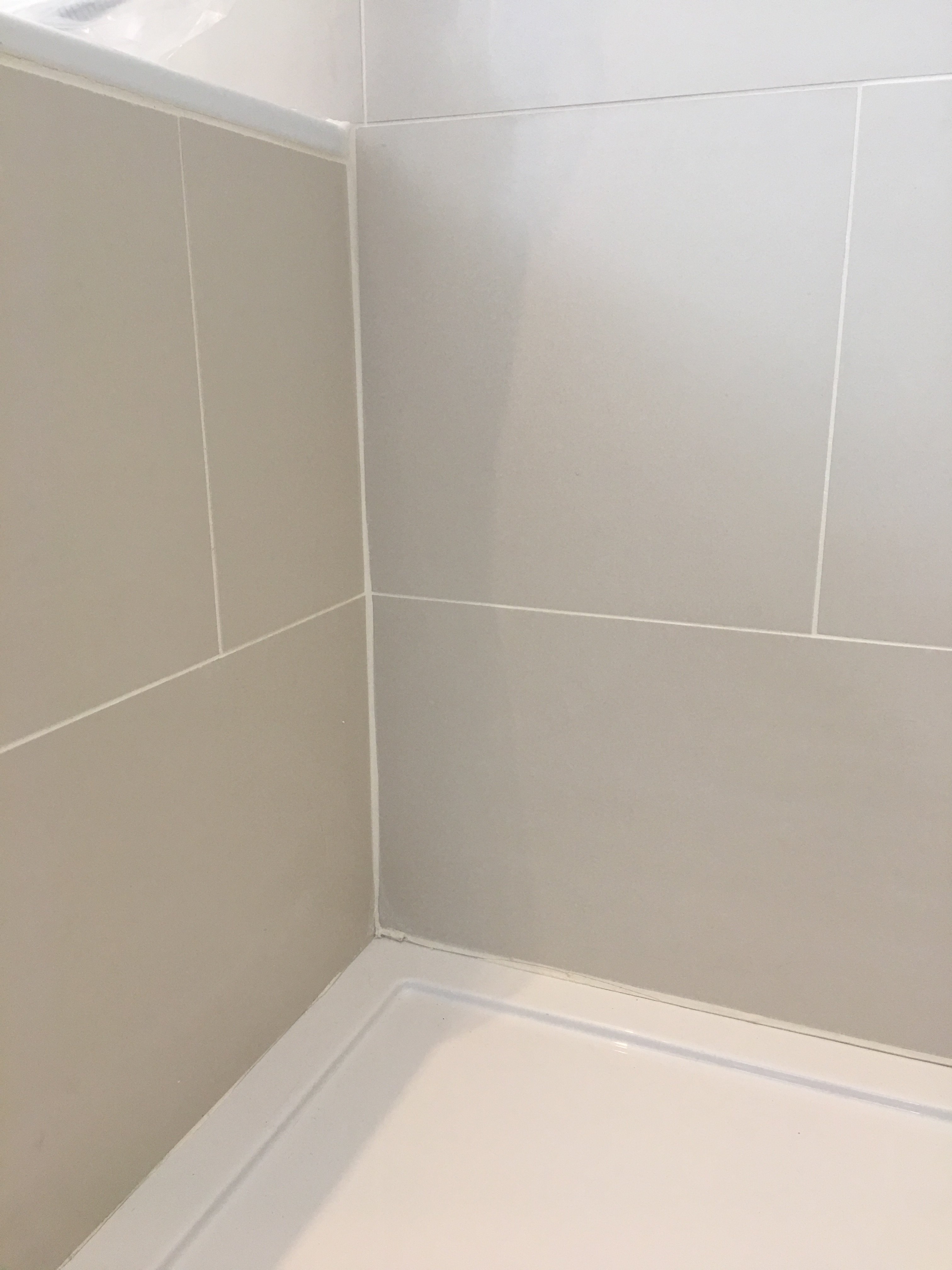

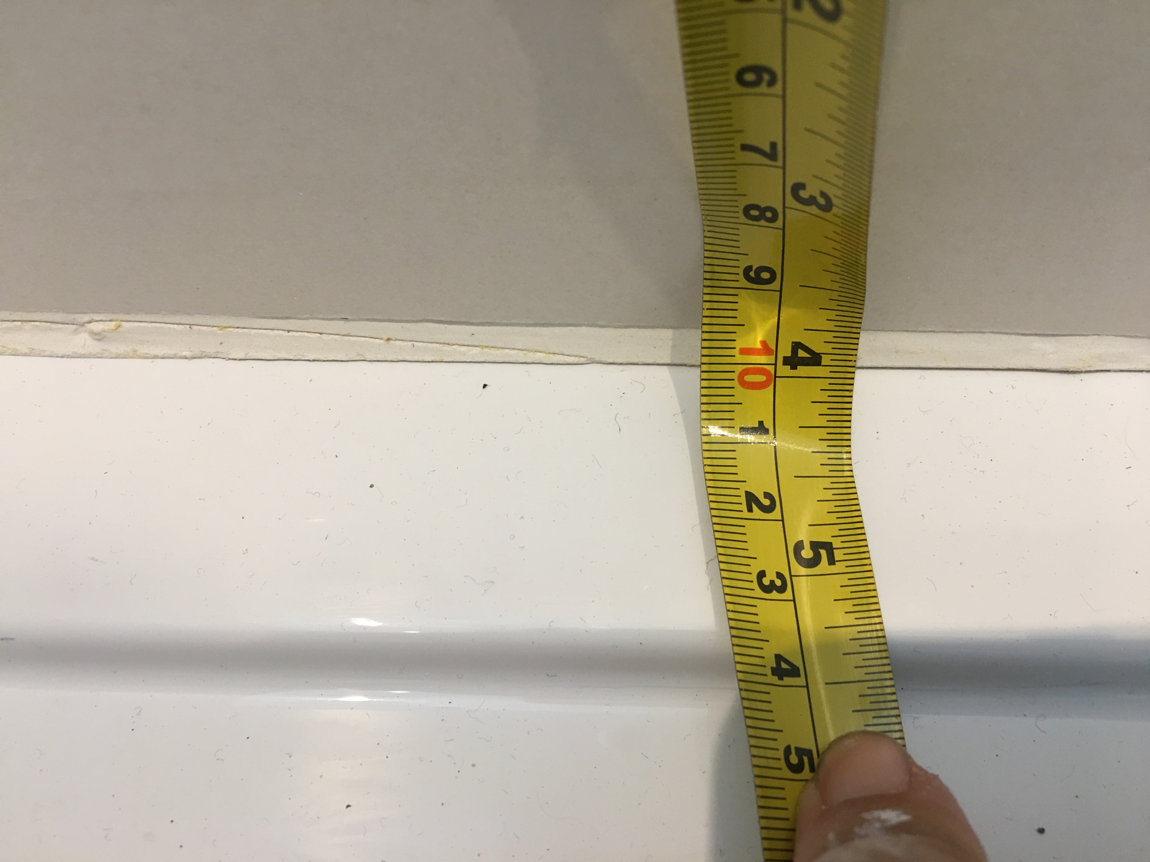

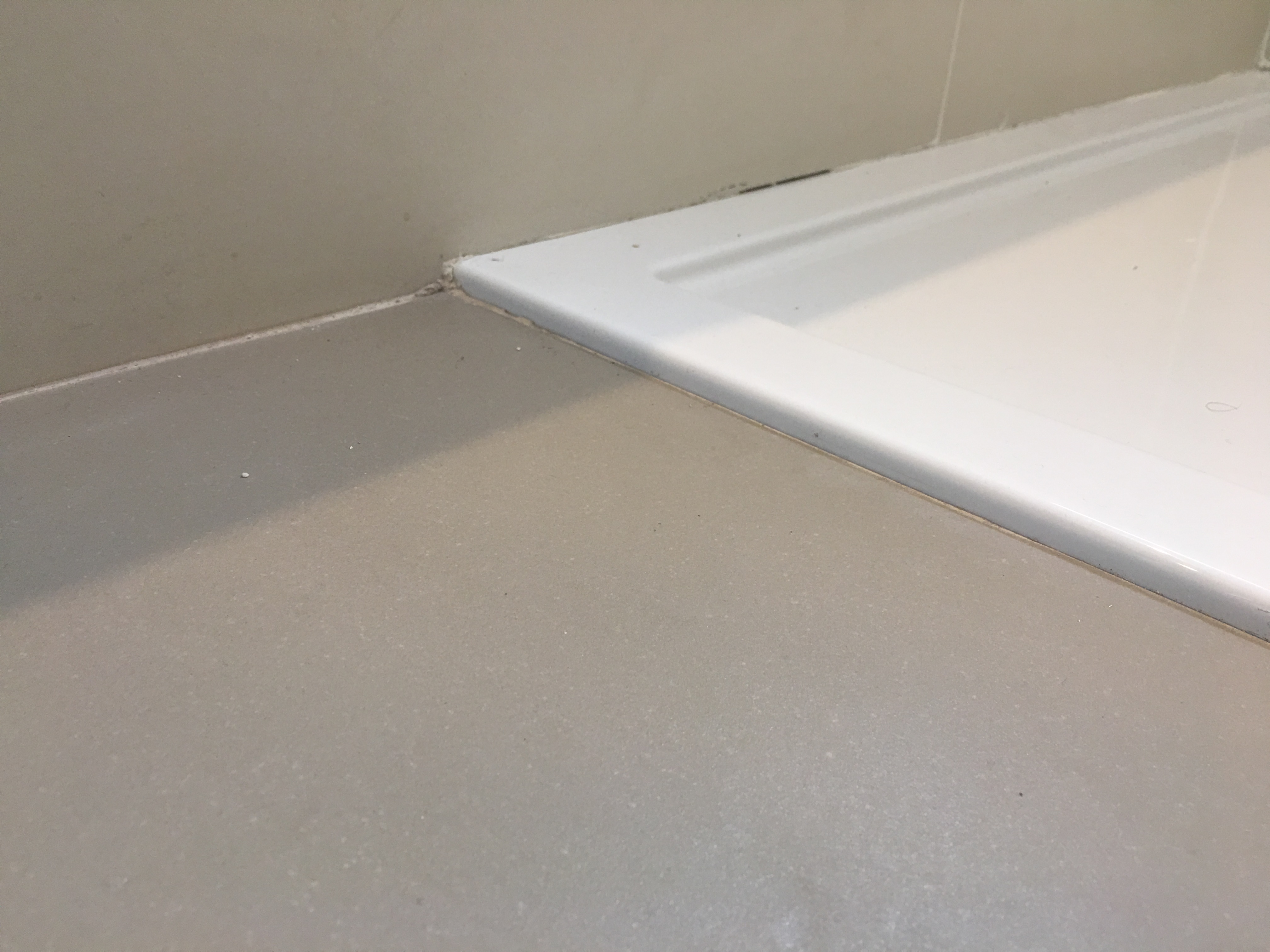

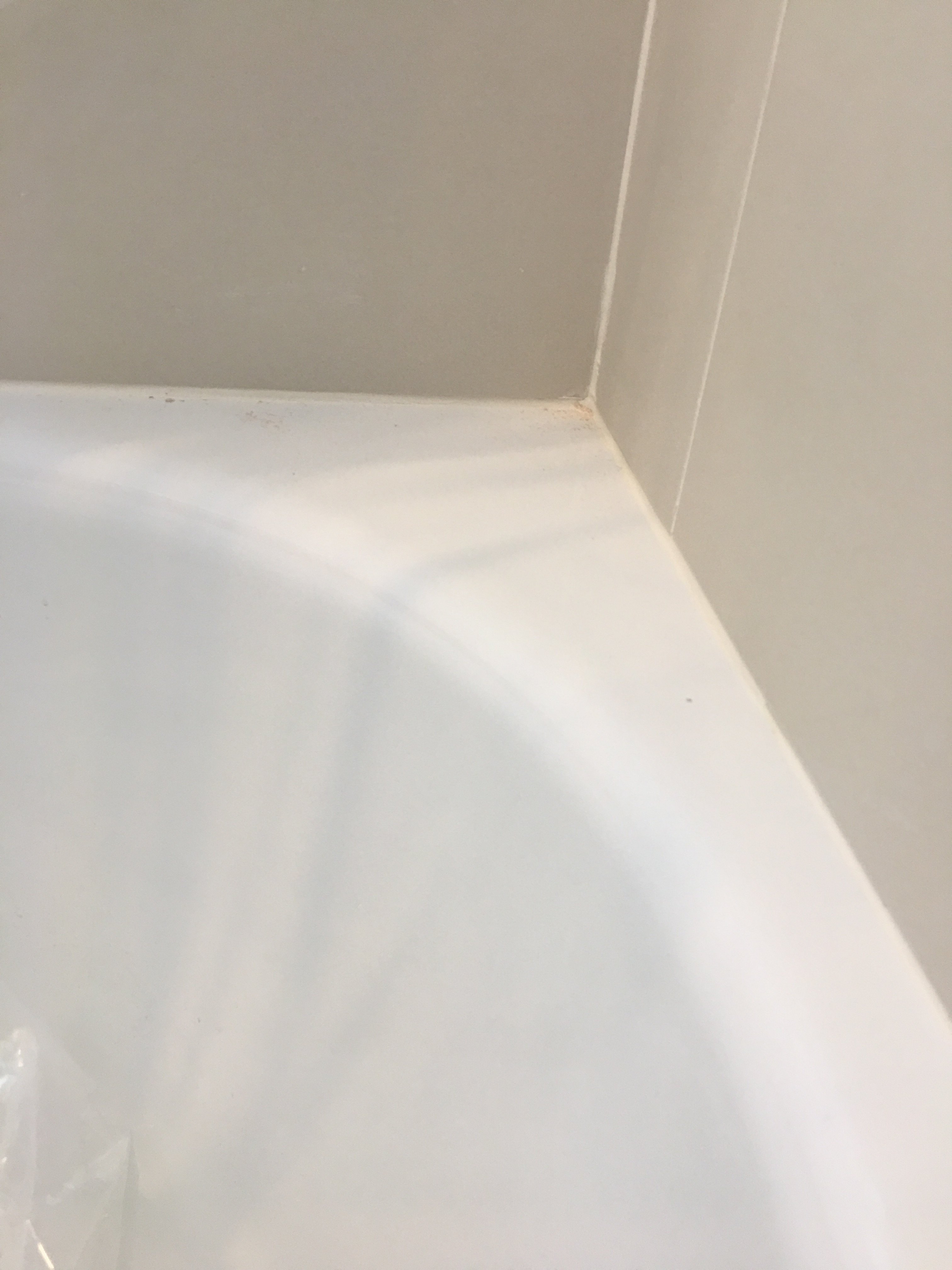

Iva attached photos showing grout all around the shower tray, bath, and where tiles meet tiles in the corner of two walls.
Am I going to have to ask him to remove all of this grout? And is it actually possible without him damaging anything?
