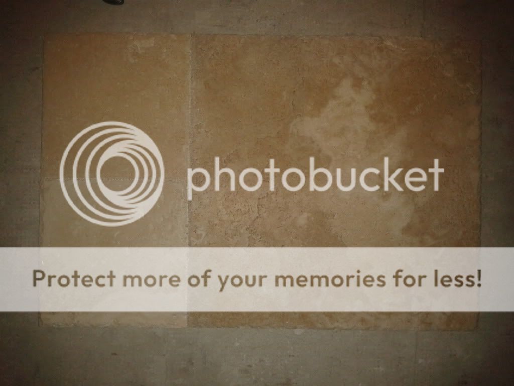

My usual tile shop has a new supplier of trav, It seems better quality stone, but is chiselled edged instead of tumbled, and odd sized
I've laid some out in a french pattern and they haven't allowed for the width of the joints, they are 24x16,16x16, 16x8 and 8x8 exactly:mad2:
Is there a different pattern that you use if you come across this?
Do you keep these tiles close together,I reckon they could be laid with a 2mm joint, of course, the chisselled edge,when grouted, will look much wider will it not?(grey grout to be used)
This is them

you need to have a much bigger gap on these tiles 6 mm if you are mixing different sizes i would lay them out starting with the biggest work the tiles round this gets to form a repeat interlocking pattern always comming back on it self. most tile shops that sell this kind of tile should have a pattern book for you to follow .never liked these tiles my self .grout always gets dirty but iam told this is the rustick look
Rizzle from the Portizzle
it must be a london thing always been asked for a wider joint have laid hundreds of m2 of these very popualr 10 years a go normaly ivory grout . if you lay these at 2 mm joints and you find they get a bit sizey you will find your self stuggling to keep floor square. tip get six of each tile push them tight together and check the square if 2 mm out add this to your grout joint. check first fix once

Ok, so I think I was worried unnecessarily. I think it will turn out ok (wont know for sure until its grouted). I laid them with a 2-3mm joint,
I even reduced the tiles by 20mm and redressed them where they go through the door to help the layout in the next room
Lovely stone though
