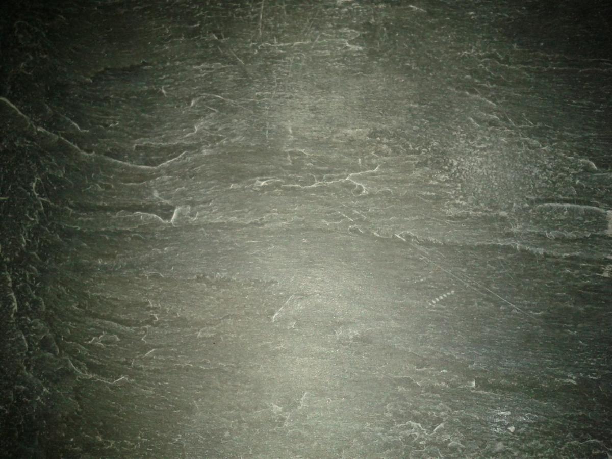

I have been trying to clean my kitchen slate floor. I have used LTP grimex which has cleaned off the sealer and general dirt and grease form the floor.
Im still left with dirty grout lines and grout deposits on some of the tiles
Any advice on how to remove this would be greatly appreciated?

You ideally need a rotary with soft to medium brush and a wet vac then I would use then since you are already using LTP grout stain remover pre-wet the floor put it on agitate it and allow to dwell 5-10minutes then agitate again then vac it up. Allow it to dry personally give it a good 24hours so the stone is dry surface and throughout the whole stone then seal with a colour enhancing sealer.

Sorry just to clarify i should use some LTp grout stain remover and agitate with a brush, before resealing.
