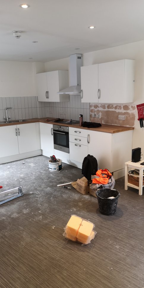

Started a job, tiling 5 kitchens on Monday, I had got nearly 3 of them finished when the client come in and said he has found problems with my tiling, baring in mind up to this conversation he had been in and out several times a day, saying what a good job it looked and he was happy. he has been round with a spirit level, and quote 'if you look through the window at them they dont line up with the window frame'..... at this point i was getting frustrated as my work i thought was to a good standard, and he had previously been happy with the job, He said either strip all 3 down and do it again or he would get someone else, at this point I was confused to why he all of a sudden didnt like my tiling after 3 days, so I agreed to pay for the materials i had used and leave,, I lost £660 labour and £351 materials.....anyone else ever had this problem? can I get my money back or do i just move on.... I have uploaded pictures of my work.

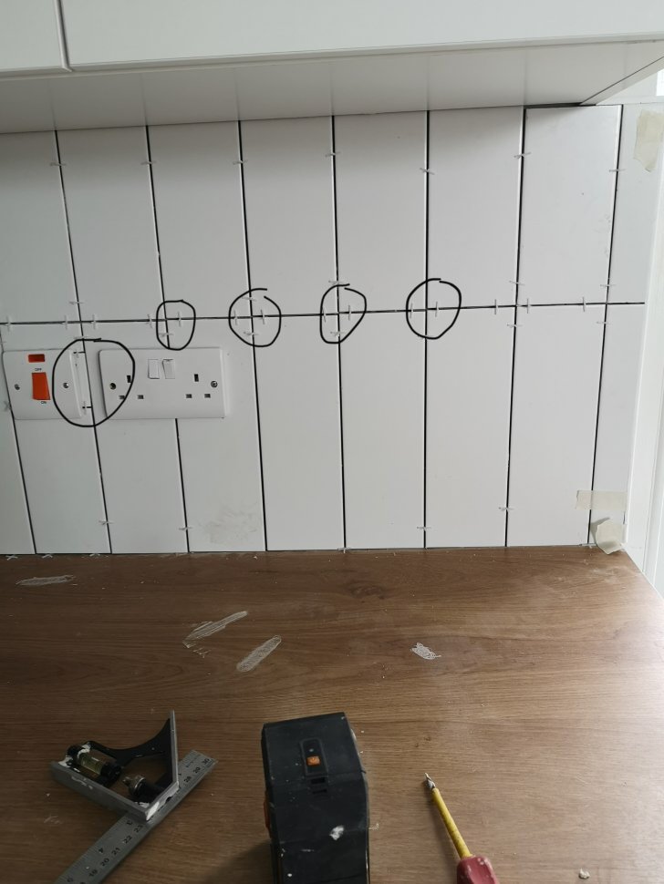

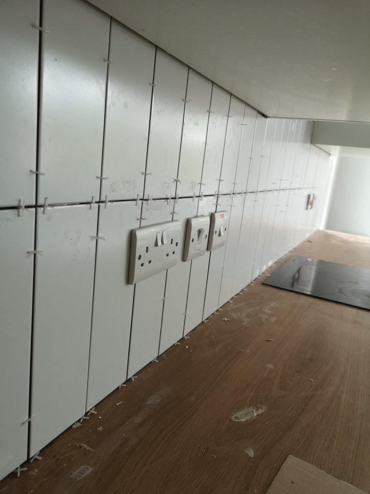

Are the bottom rows cuts? the cut around cooker socket picture 3 is acceptable.
Some are cuts to keep it as level as i can, normally i work with the worktop, but he said that wrong

Having a closer look at your photos I guess I can see what the client is saying.
The circled joints all seem to step down and the slither cut to the side of the cooker switch isn't good enough to be classed a professional finish.
Did you offer to remedy any issues?

No, he wanted to strip it all out and start again, but I was concerned I would do it, and he still wouldn't like it,

The client shouldn’t be telling you how to do your job, you’re the professional.
At £220 a day you should be providing a top quality job and I feel it falls short of that, imho.
