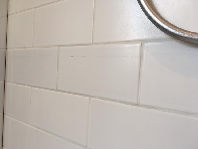

I've had a customer come back to me with some cracked tiles in his bathroom. Its 12mm no more ply, I've called them and apparently it has to be glued on the joins AND to the stud work, who knew?
Anyone else had any issues with this? I've fitted all the other types of tiling board i can think of, wedi, marmox, aquapanel, hardi etc but i've never heard of having to glue them to the stud work as well, so I didnt glue this one either. :/
I'm getting flak of this guy now as I dont have an answer for him to recitify it without taking out and starting again. If i cut out the 10 cracked ones and cut the join in the boards and glue it with the NMP glue, whats to say it wont crack again?
Any thoughts please?
