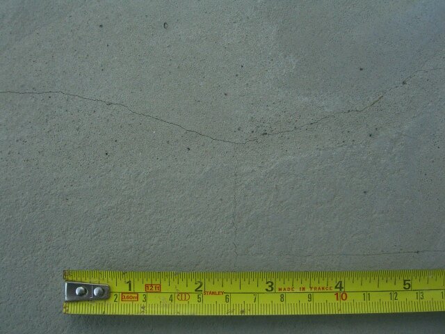

I have a new conservatory completed at the end of last year. After allowing the 100mm concrete to dry, I primed and fixed 50mm Fastwarm insulation boards using Ultra RS flexible adhesive, layed out the underfloor heating cable and covered it in approx 7 mm of Level It 1 SLC. This morning after 4 days drying, hairline cracks have appeared. Some of these areas sound different to areas without cracks and also vibration can be felt when tapped. Most cracking appears to be in areas where the SLC is less deep. How should I proceed before tiling? Should I pour more SLC in these areas or will the flexi adhesive under the 600 x 600mm porcelain tiles cope with this?

First things first, obviously don't tile it. I wouldn't cover it with another layer either. Hollow sounding SLC isn't good.
Can you upload a picture or two by chance? It would really help.
It sounds like either the SLC has been mixed wrong, used incorrectly, is a dodgy batch, or the heating has been turned on during the drying process. SLC shouldn't take 4 days to dry. I'm guessing it dried 3 days ago but you left it another just to be sure?

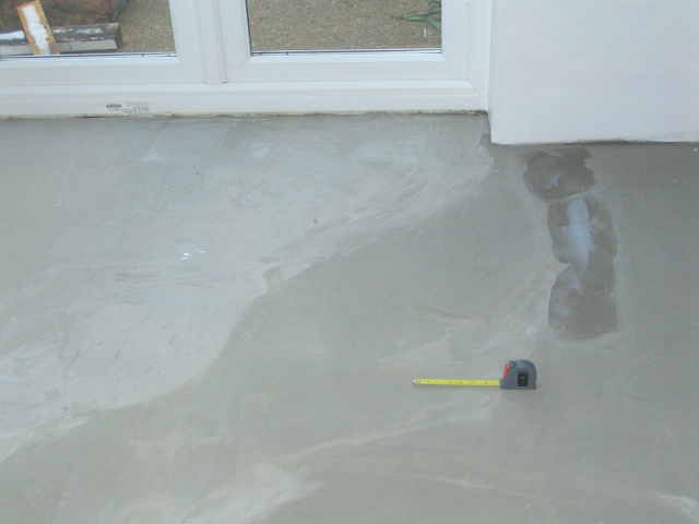

No, the heating is not commissioned yet. I have not been in a hurry to tile, thought it should dry completely first, painted walls yesterday, only noticed cracks this morning. I think cracking is maybe in areas where the insulation boards are taped together using board jointing tape and above cables where slc less thick. I also used Wickes SLC with no cracks! View attachment 38483 View attachment 38484

I'd hate to say use another bag or two and tile it and then it screw up in weeks/months time. Screed isn't my thing so macten's your man for that. But the SLC looks like it's got the cracks where two different mixes of SLC have been used. Not sure what that proves/gives us though. Then if I zoom in a bit it looks like around the crack the water has ran away from the SLC causing it to perhaps cure with less water than the rest. Does it feel like there's a bit of a dip near where that crack is above the ones that's next to the tape measure? Looks like it's putted a bit as if the water in the SLC has ran under the boards perhaps or something?
What did you stick the boards down with?

The cracks are mostly where Ultra has been used. There has been a bit of run between boards so there are a few low areas and where the two mixes meet. The slightly hollow sounding area has perhaps thinner layer and also needs raising. The area above the tape measure I filled with tile adhesive to level. I used the tape supplied with the boards to join them together and fixed to floor with Ultra RS Flexible adhesive.
