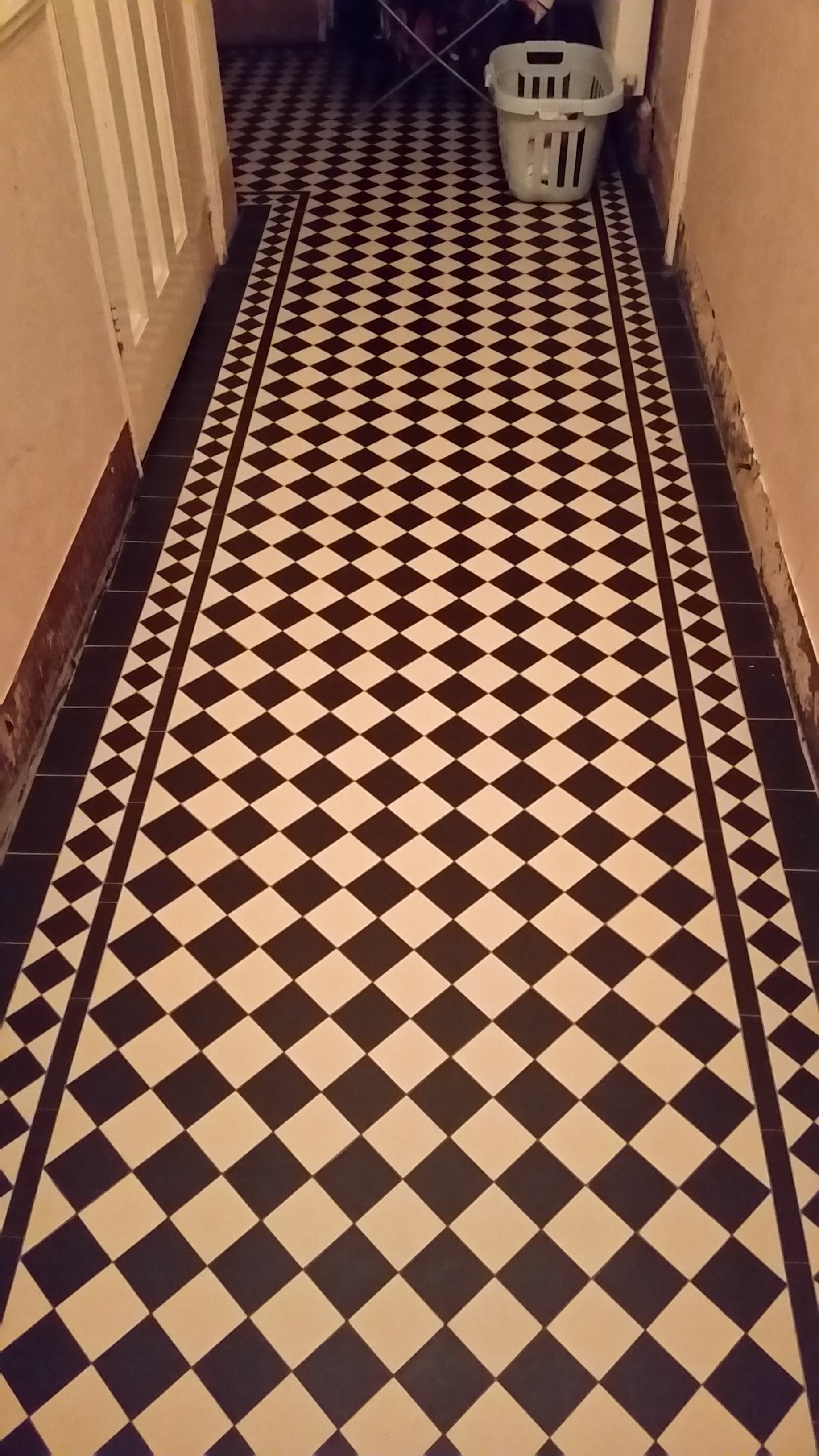

Hello all,
I had my hallway floor installes by a builder 3 years ago, dug out, underfloor heating and victorian tiles laid. Now they are crunching underneath in a part where the underfloor heating is (its not all the way underneath). No signs of cracking or lifting yet.

The underfloor heating is water.
My line of thought is the same re the builder..
Picture attached hopefully.
It can take 10 months to dry out with dehumidifier before you can tile on a flooded area and if the water got under the tiles after they were installed it will have released the bond.
Not your builders issue but you should contact your insurance company as it was obviously something that has come to light since loss adjusters report!
