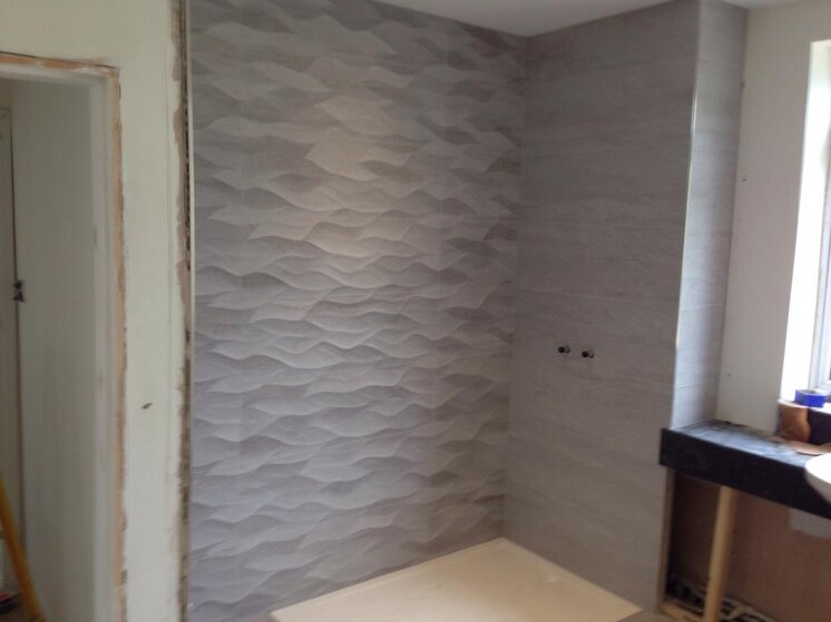

I cut mine on my Sigma with no probs but if you are having little success , then I would advise to wet cut them
pic of ones I did , ,1 mtr in length.
