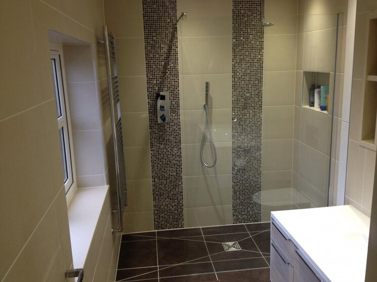

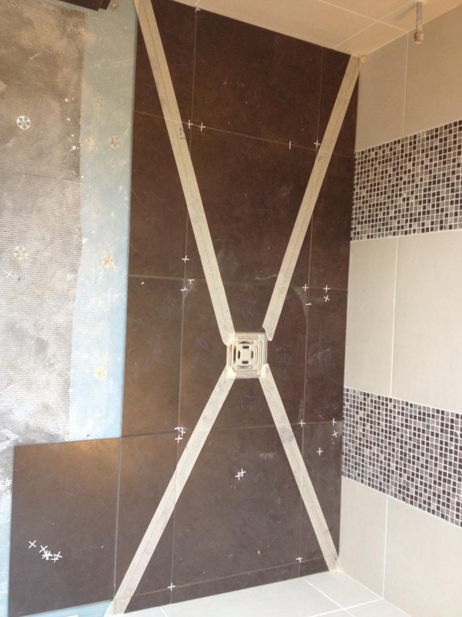

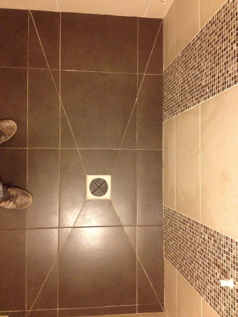

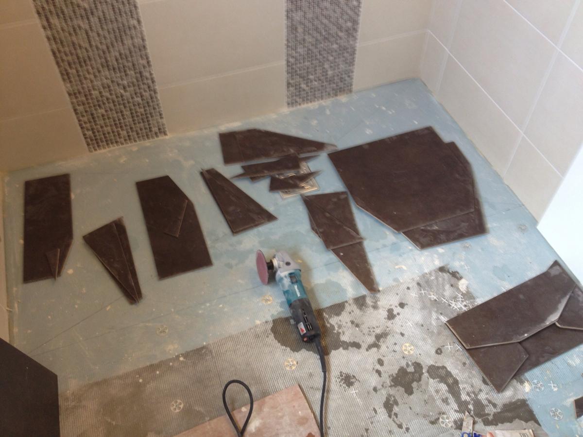

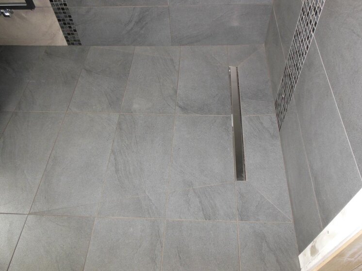

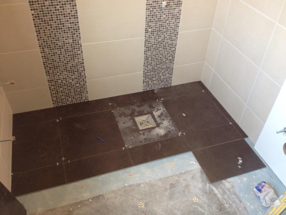

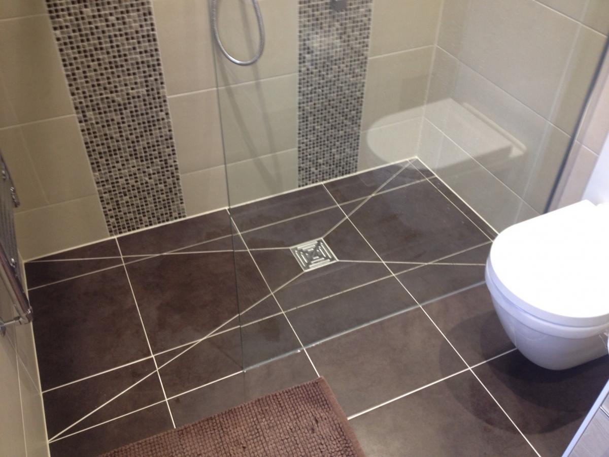

Not sure how everyone else does this but this is the way I do em.
1. Cut out for drain and lay the rest of the tray tiles.
2. Lay masking tape from the corners, mark out and number cuts with a wax crayon.
3. Cut tiles with wet saw to create a gap and polish the cut edges ( now using new polishing toy from " ats diamond")
4. Fit jigsaw to tray former. (Grouting tomorrow )
