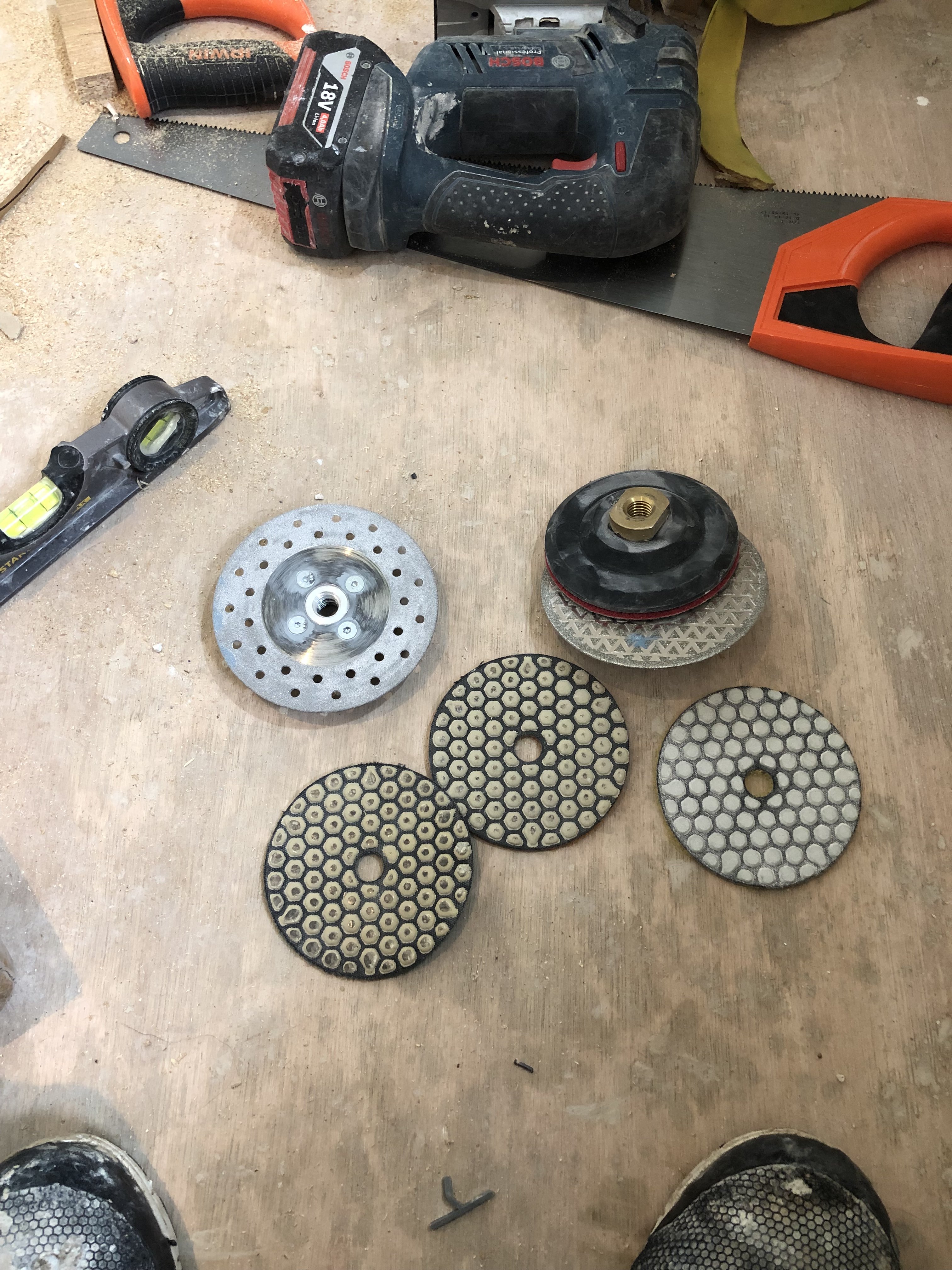

Doing some this week. Probably cost me £30 for the set. Used them on ceramic and porcelain.
The one julian posted looks good as it looks like fine diamonds on there. That’s where you need to be careful. Using sanding pads etc takes out the risk of chipping. A lot does depend on the tiles you’re mitring though.
I’ve never used the paper abrasive pads so can’t comment on them or compare. I must get some at some point.
The diamond discs I have seen and look interesting aswell, read they need bedded in alot to get them to work and as it's DIY wouldn't get alot of use.
Where did you purchase them, seem some on eBay that look decent at £4.95 per disc so can select the grits you need.
Did you mean the grinding blade can cause chips?
