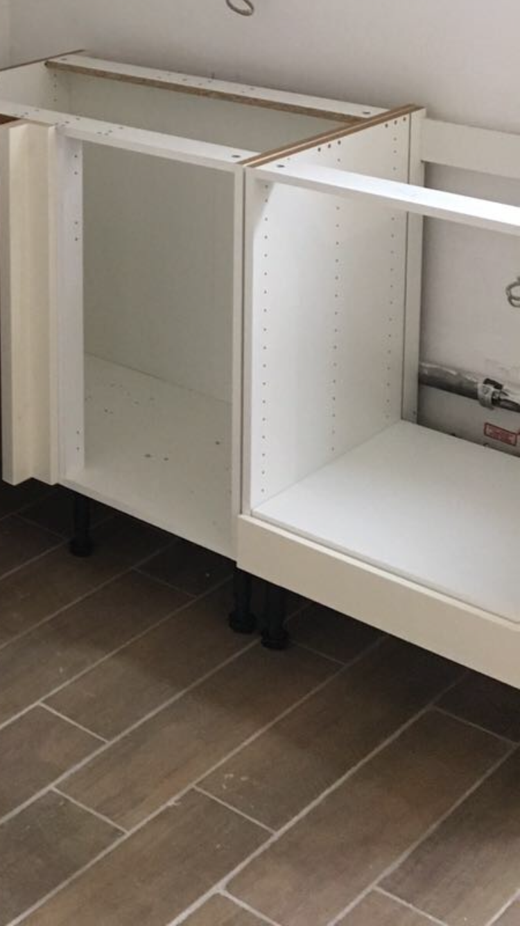

So I just started tiling my house, I am a bit of a novice but thought I would give it a go.
Me and my wife have purchased a house and decided to tile the whole of the downstairs in the wood effect porcelain type plank 150 x 600 (about 70sq metres)
I stared using Mapei ultra colour grout on the floor tiles and took on
10 sq metres in 1 go BIG mistake.
It dried to quick and I managed to clean the face of the tiles but the grout lines are a bit thick ( 3m spaces used)
The grout lines look a big jagged so instead of having a nice line there are bits slightly over.
Any suggestions on removing the excess?
You must pre wet the area with water, then put down the acid (you'll probably have to use it neat) and agitate with a white scourer for a couple of minutes.
Leave to work for a few more, do not let it dry on the tiles.
Neutralise with water and
a white scourer (clean one)
Then the best way to remove the dirty water is with a wet vac.
You just move the grout residue around otherwise.

It's been 5 days as I've had other house jobs to get on with but I need to sort this now i have more time
Plus it's sticking out like a sore thumb
Yeah that's a bit of a mistake.
It should never have been left. The longer you leave it the more it will cure and the more likelihood it'll have to be mechanically removed.
