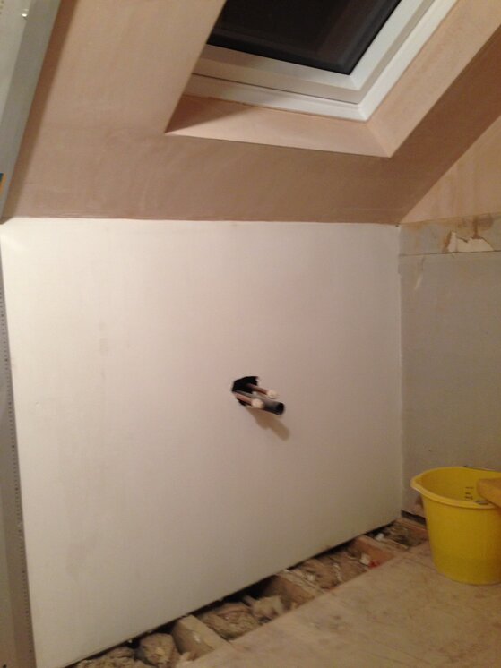

If u do u need to find out if they're translucent!
A large number of glass mosaics are.
If so u'll need to prep walls like this.
U'll need to white them out first or they'll look completely different when you fit them.

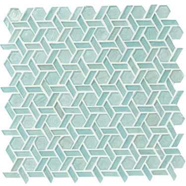

I've worked with these mosaics they're translucent and paper faced. Even though the sheets interlock they will need some adjustment so don't fix too many sheets at once before you take the paper off. Take your time. Use a very white adhesive.
I applied the addy with a 3mm trowel and then lightly ran a straight edge (such as a wide scraper) over it to get rid of the grooves otherwise they'll show up through the glass. Some pieces needed an extra bit of pressure so there weren't any air pockets showing.
They cut fine with a decent glass cutting blade on a grinder.
