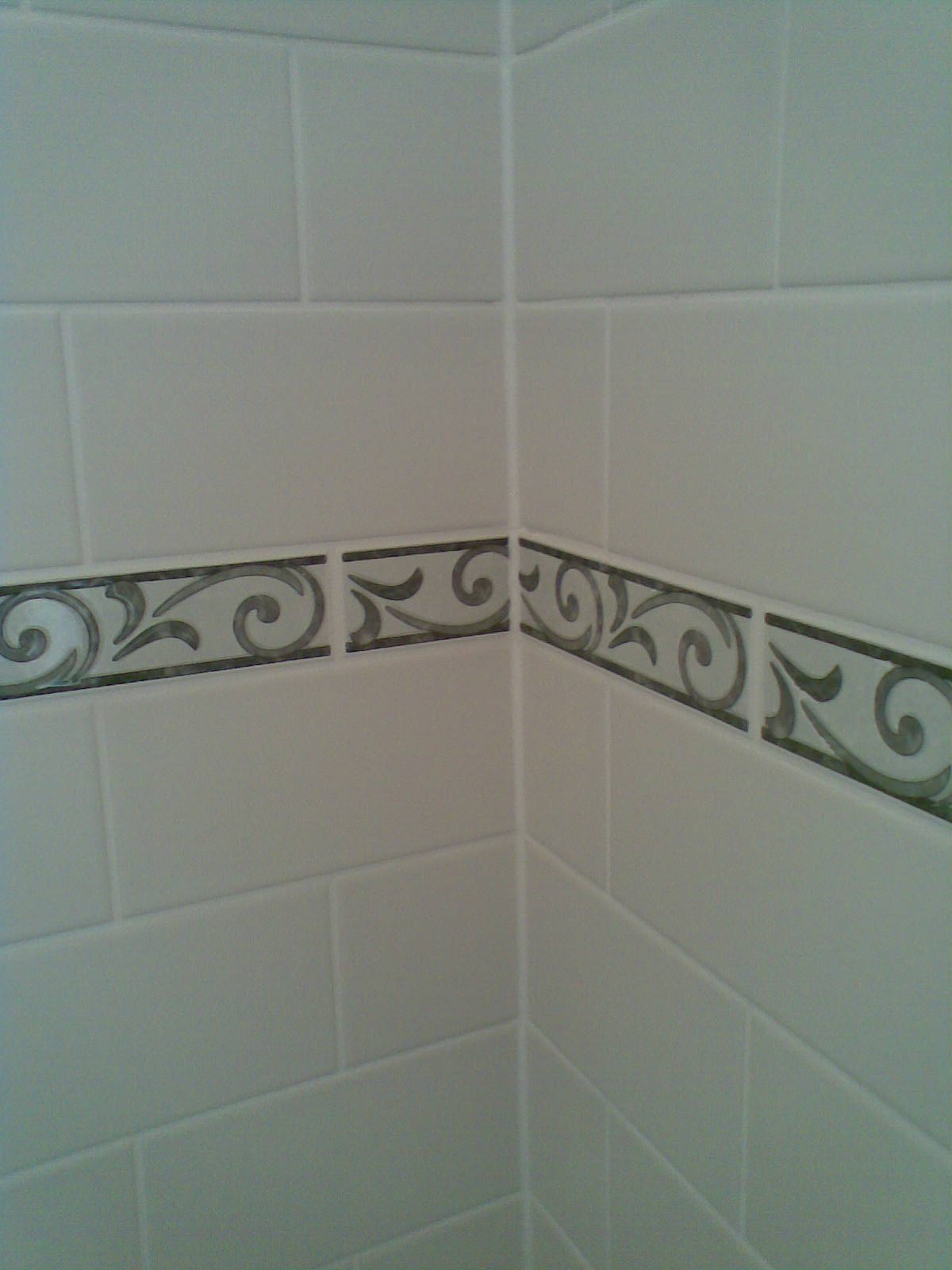

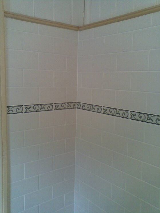

Here's a few pics of a brick bond bathroom I did last week.
Note that you can't always get the pattern to work because it will leave bad cuts elsewhere. In saying this though the larger the tiles and the darker the colour the more important it is to match the pattern. I was lucky this job was in white 200x100. If I was 400x200 black or another dark colour my set-out would have changed.
