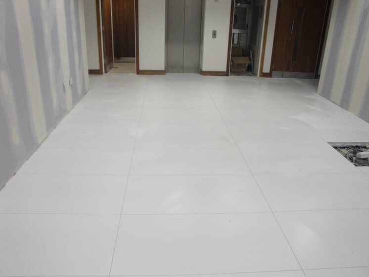

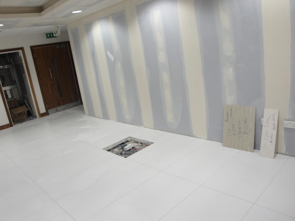

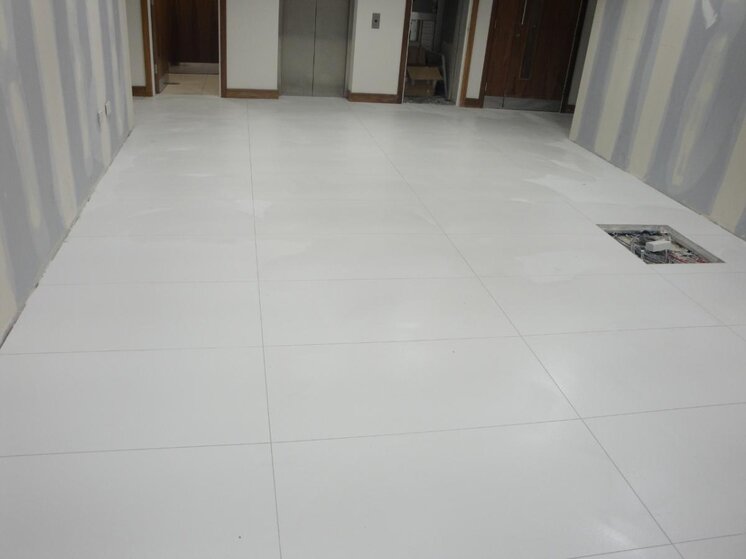

here is some video of the first trial of Ray's Tile iron vibration machine which aids solid bed fixing ,I didnt get the hang of it at first and was pressing far too lightly as I was fightened it would damage the tiles and it took me about 10 tiles to get the hang of using it ,it definitely helps achieve a solid bed once you use it correct and apply the pressure from the centre and literally iron out the air from underneath the tile I will post some pictures of the finished job too [video=youtube;Y3wCgvXQySI]http://www.youtube.com/watch?v=Y3wCgvXQySI[/video]

that did not work at all. more adhesive was put under the tile every time. obvs get 100% coverage keep lifting and putting more underneath.
no it didnt work well at first as I was frightened to put any pressure on it as I thought it would damage the tiles once I started to put my weight on it and work from the centre of the tile out to the edges it did start working well I will do another video on the next job I use it on to show it better:thumbsup:
