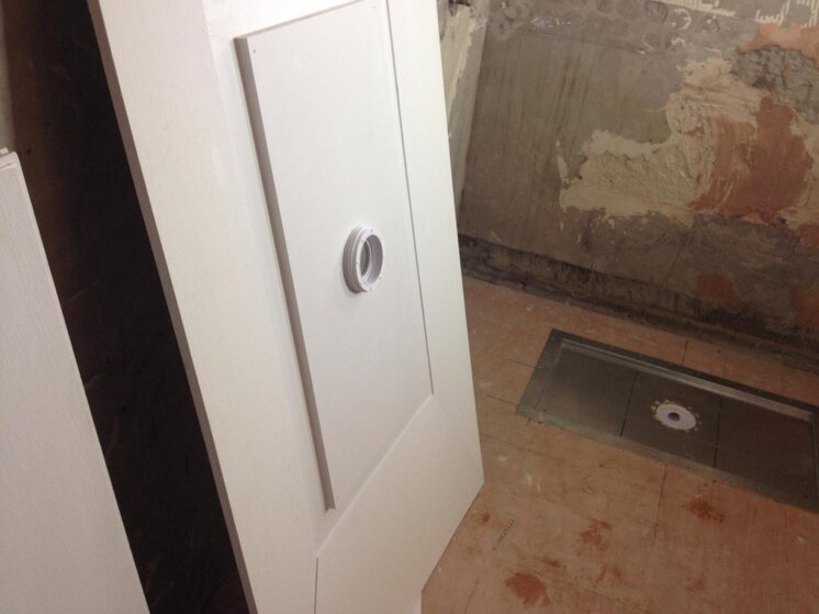

1 . The kit I ordered comprises of a 900 x 1700 mm tray former, 6no 1200mm x 700mm floor panels amd 4no 150mm skirting panels.

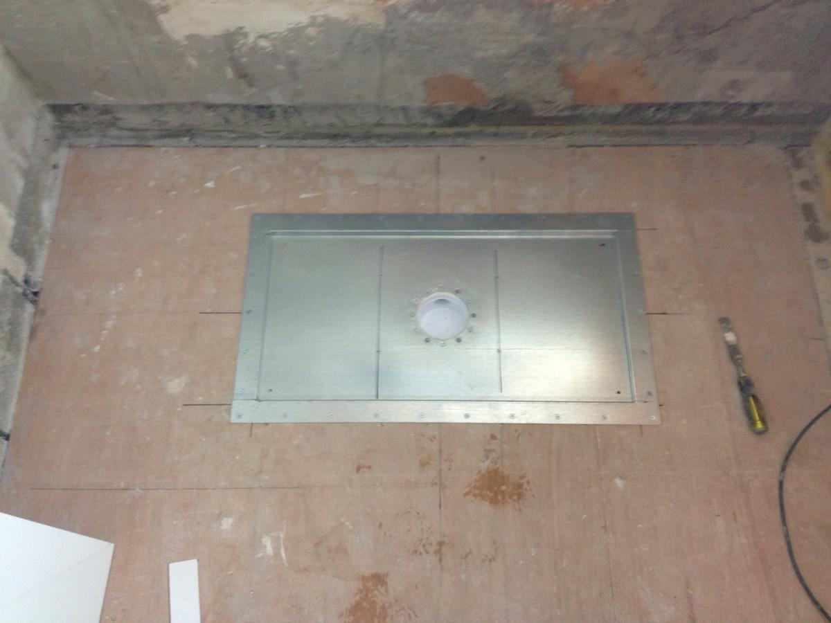

3 marking out or the steel support tray. This tray comes with a steel former that sits onto the joists and is recessed onto the floor. The tray then sits into this and creates the fall.

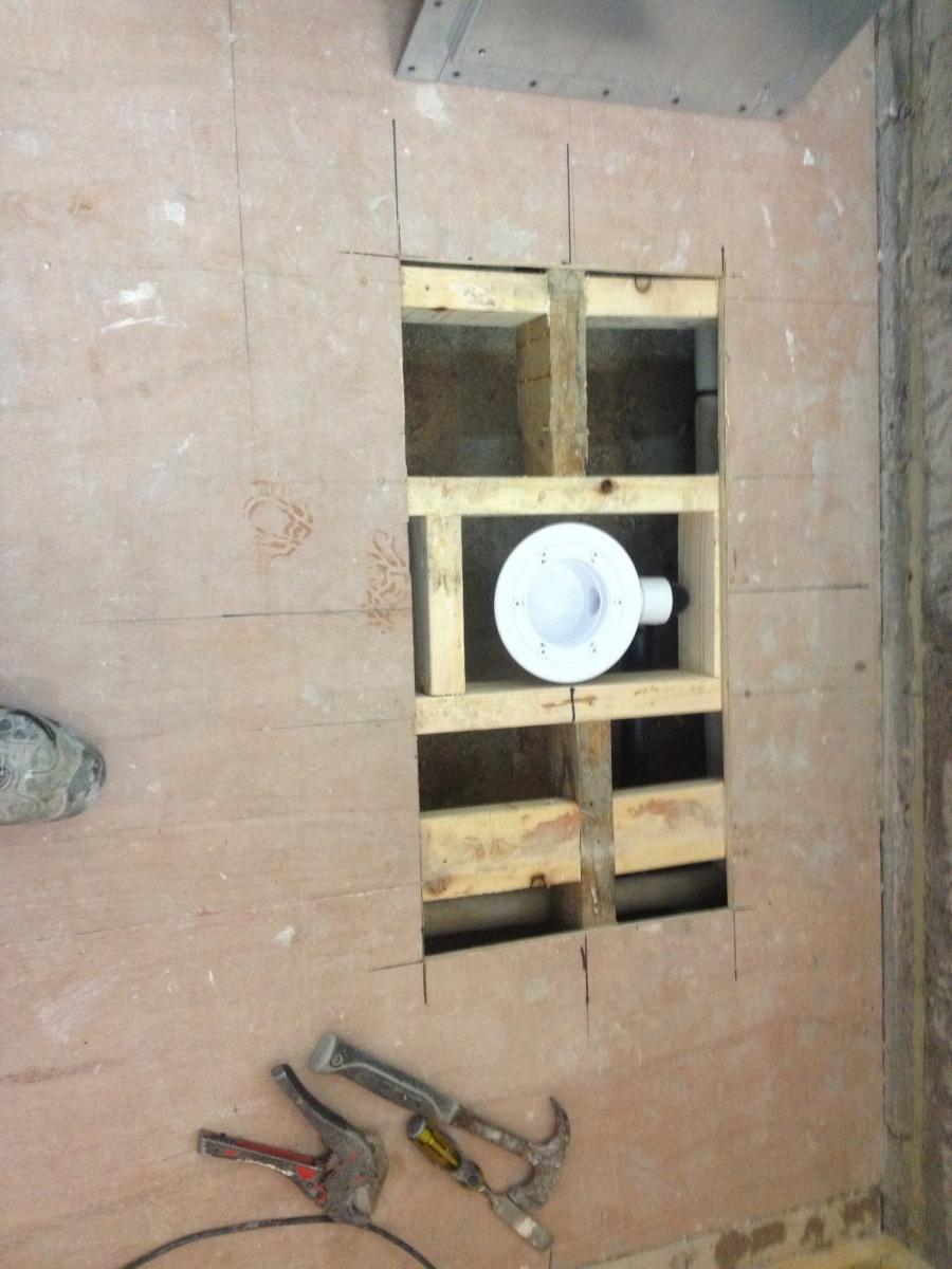

4 cut out the floor and pipe up for the waste.

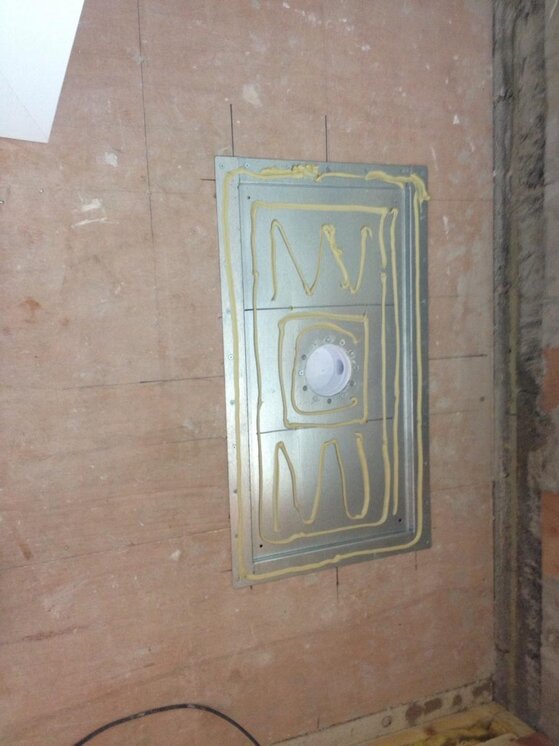

5 fitting the waste to the steel tray and screwing down. You have to also drill holes in the base to fasten the metal tray to the joists. ( these need to be countersunk.
6 . Fit the waste adaptor to the tray ( this comes with an o ring seal)
7 . Run in the glue (provided with waste) to the steel tray to stick the tray former.

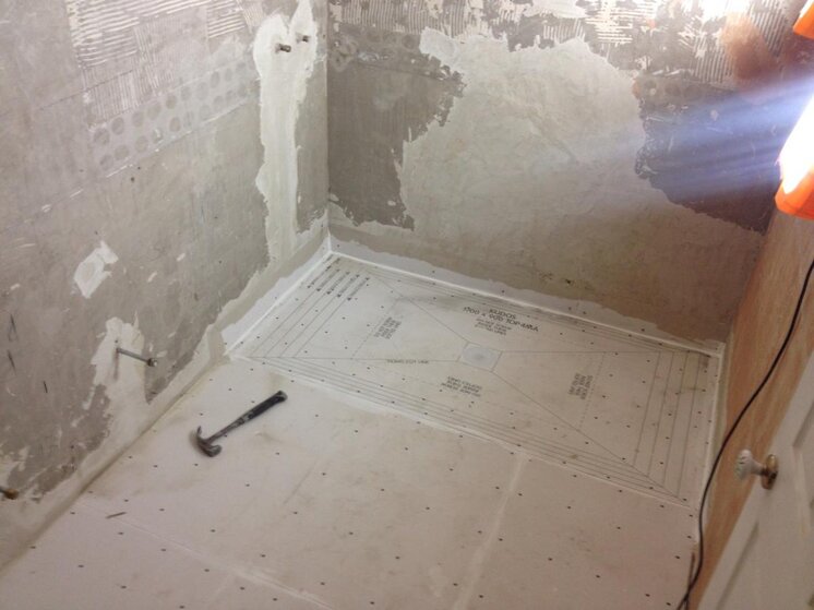

8. Lay in the tray and push the waste fitting in to locate, then walk on the tray to make contact with the adhesive. Then using a collated screw gun fix down the rest of the tray.
9 fit the floor panels , ( these are toungue and groove) with the plastic adhesive. And fit the skirting pieces in the shower area.
ready for tanking the walls tomorrow . image.jpg image.jpg image.jpg image.jpg image.jpg image.jpg image.jpg image.jpg image.jpg
