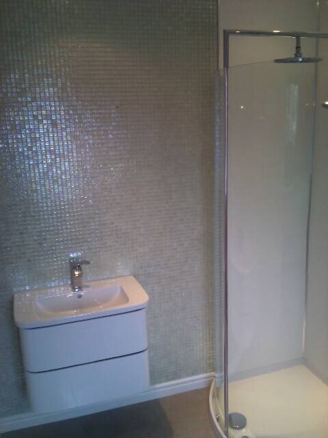

darren i cut the teeth longer in my trowel then beat the tiles in once you remove the paper the tiles can be straightened if need be and the joints cleaned out with a brush you cant see any trowel marks if you do this and the extra adhesive alows you to move the mosaic easily if needs be with a worn trowel or the back edge a 12 inch hack saw blade
4mm trowel and use white Bal mosaic fix for glass tiles. By the time you press the tiles into place the adhesive has spread over the back . It has excellent adhesion and they don't slip. Bit more £ but well worth it for being white. 1318588563641.jpg
