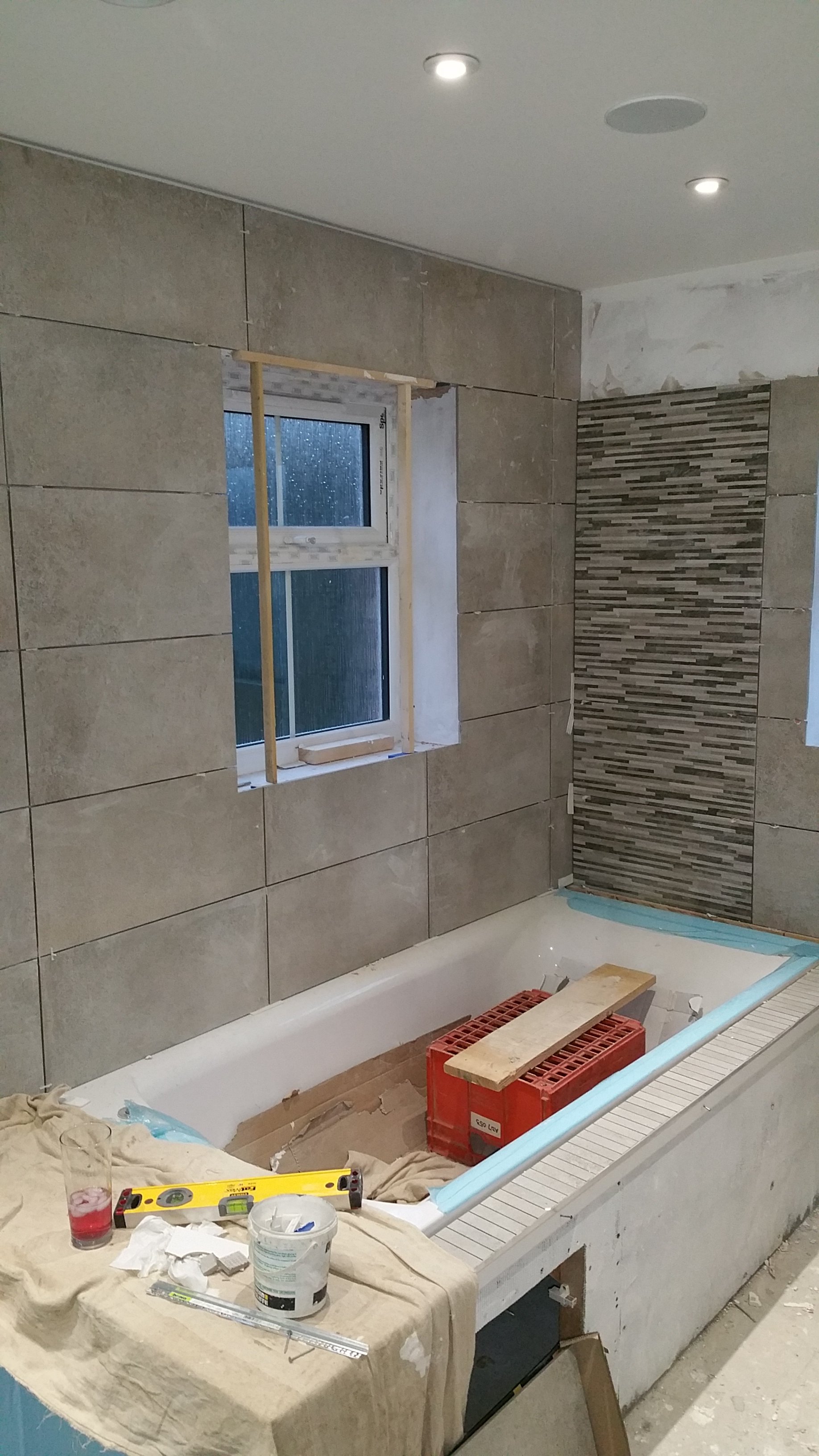

When I did mine I tiled the wall going past all 4 recessed by the size of tile and grout. Then fitted trim whilst tiling the 2 sides, then top then bottom.
The pic might help.
