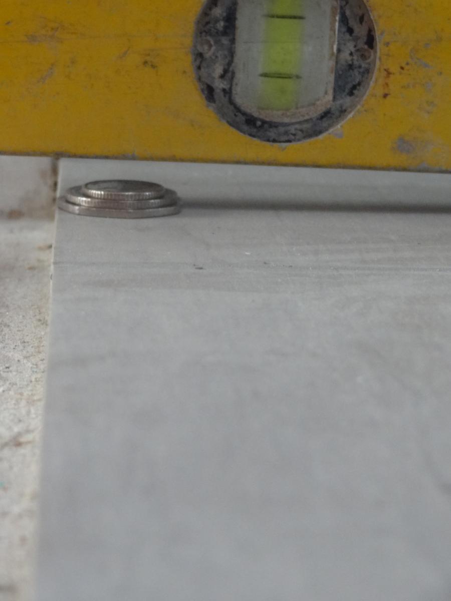

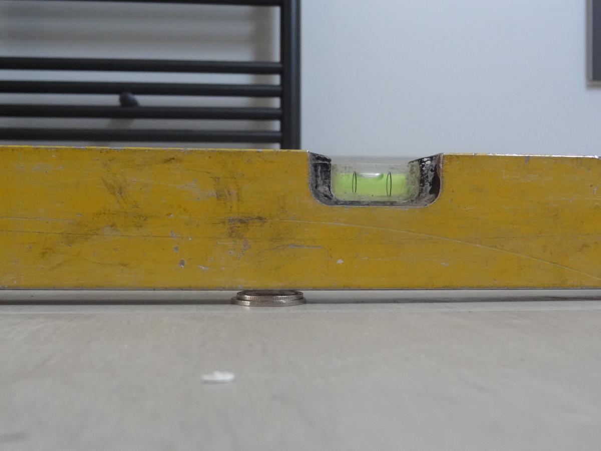

1. The floor is not at all level. I appreciate there are some tolerances which are going to be acceptable but the levels around the door are particularly uneven (out by as much as 18mm from the level of the rest of the floor. Not only is it not level around the door but it is then uneven throughout the bathroom but not to the same extent. There are plenty of areas I can put a 10p piece and 50p piece on top of each other and slide them under a 2m long spirit level. I am being told that is just the way it has to be because of the way the original floor joists are. I know we started with an uneven floor but from what I can see if it is prepared correctly this simply shouldn't be the issue it is. Can anyone tell me what I should expect, as against BS5385-3 it seems that a circa 3mm tolerance over the course of the floor is what is acceptable.

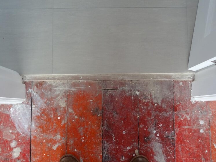

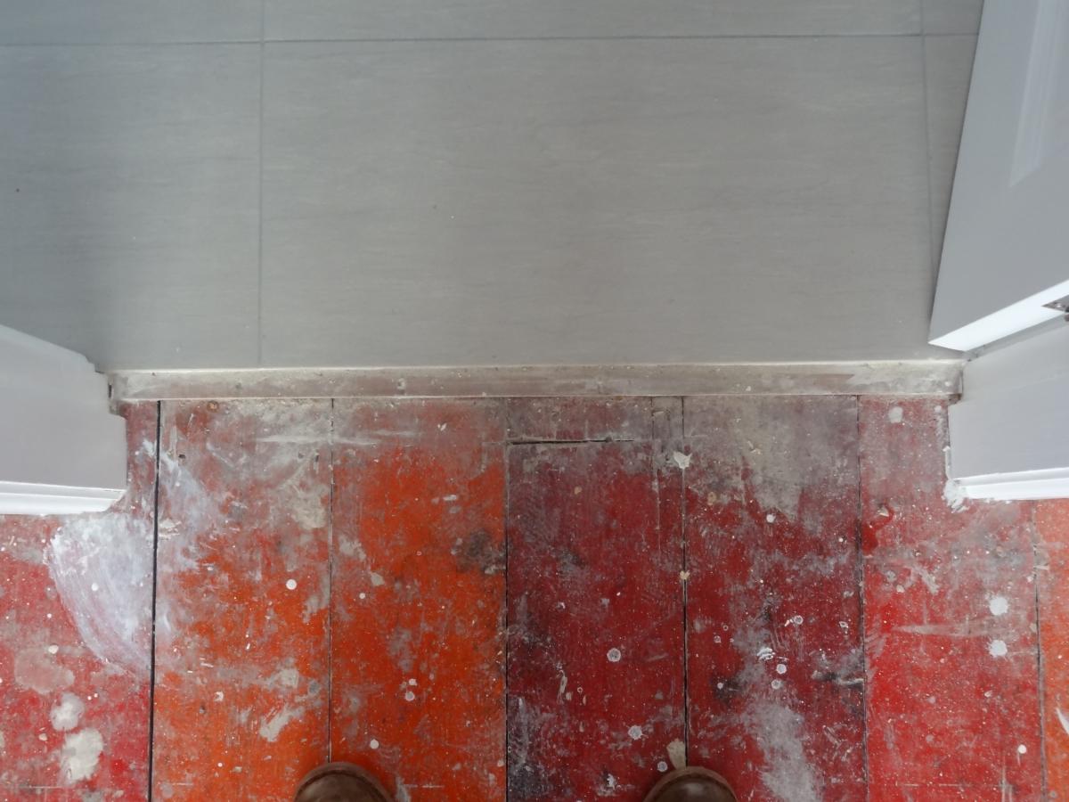

2. The floor has not been tiled into the door threshold. Again, I am being told it is perfectly acceptable to have the carpet joint showing within the bathroom. It just seems strange that when the floor has been prepared for tiling with the plywood board it has been cut into the threshold and yet when it has been tiled it hasn't. I do not think that it will look at all good and that had a little more time being spent in the preparation this would have been an issue easily resolved.

I would say that the floor is totally unacceptable as you describe and needs to come up and be redone. In these older houses a slightly out of level floor ( keeping in character with the building) is ok, but should be flat.
This will give them a chance to finish the tiles correctly under the door. Half way under so when carpet to tile bar is fitted and cannot be seen from the inside or outside when door is shut, unless you are having a hard wood threshold ( due to difference in levels) between car and tile, then it is fine as is.

You should expect a flat floor but not always a level floor. It all depends on which way the floor falls, if it falls away from the door then it can be leveled if it falls towards the door then it can't be leveled if that leveling causes an unacceptable difference in height at the door threshold. Unless of course you then raise and level floors throughout the rest of the building.
As for it being acceptable to show the threshold from within the bathroom, then no it is not. Any transition in floor coverings should happen under the door.

Thank you for your response. bathroom fitters wanted to prepare the floor so they could make sure it was right. If there was a problem with getting it level I don't think it is unreasonable to expect to have been told about this before the tiling started. Attached pictures shows the end result around the door and on the floor levels.

Regarding the finishing in the doorway, it looks to me like the 'bathroom specialist' has just started with a full tile which means that it would never have gone under the door. The tile should have been cut around the casing and slid underneath the shortened architrave.
What is the last cut size at the opposite end of the bathroom?
Have they indicated how they will be finishing the tile edge i.e. metal trim etc

As John says, looks like they started with a full tile by the door. 600x300?
Yep, they either stated full tile from the door, or he sets-out to finish a bit further under the door, starts from the other side, slightly off-course, then when he gets to the last row, its oops, I'm a bit short here, oh well!
Any pics a bit more zoomed-out from the coins - to give a look see of the bigger area

Dont worry to much about th efloor being level, just as long as its flat and theres no humps with your tiles or lips at the side of each tile then its ok.
