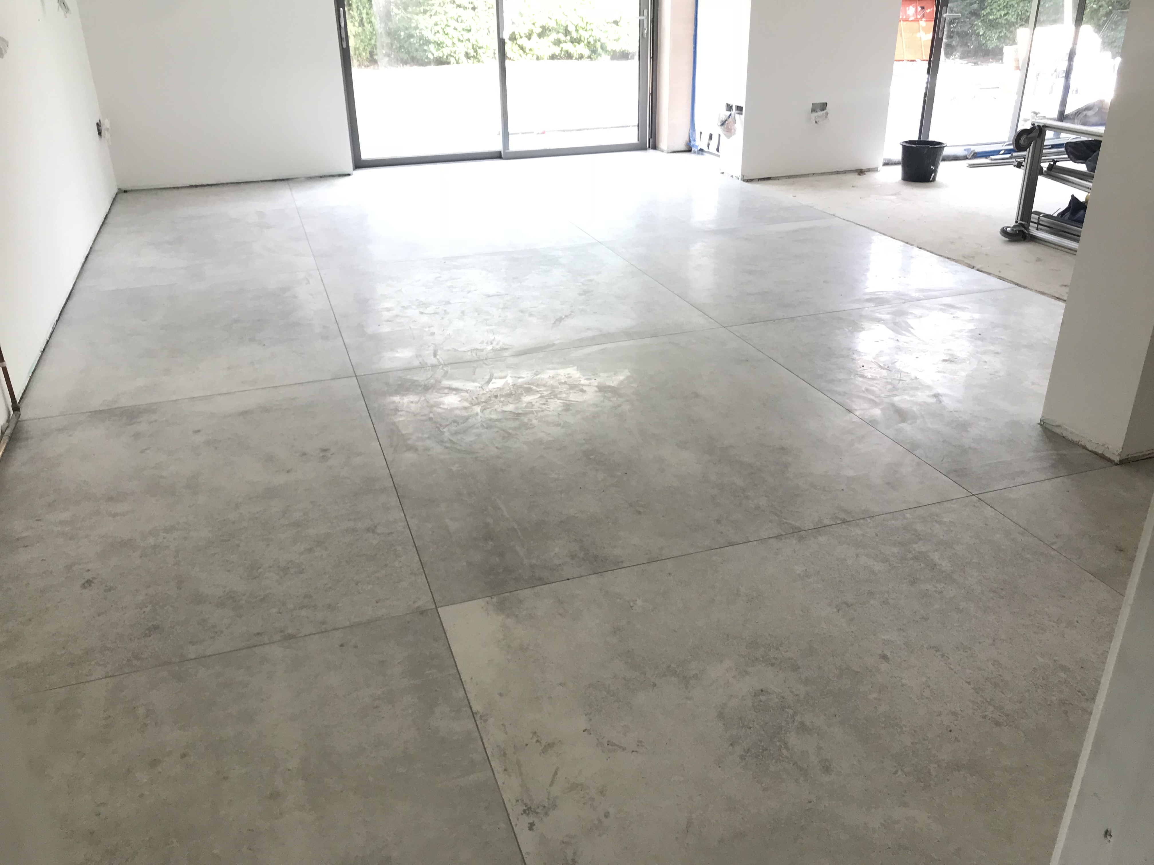

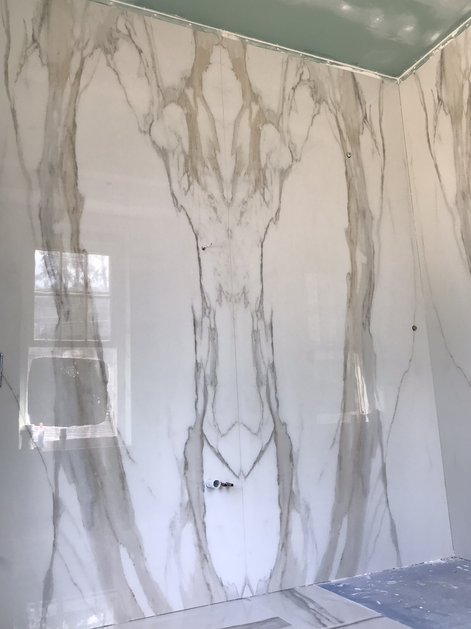

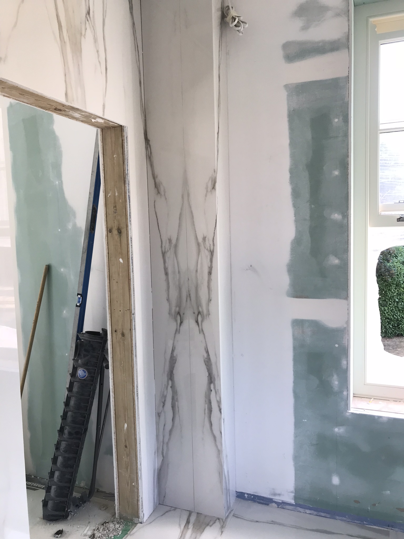

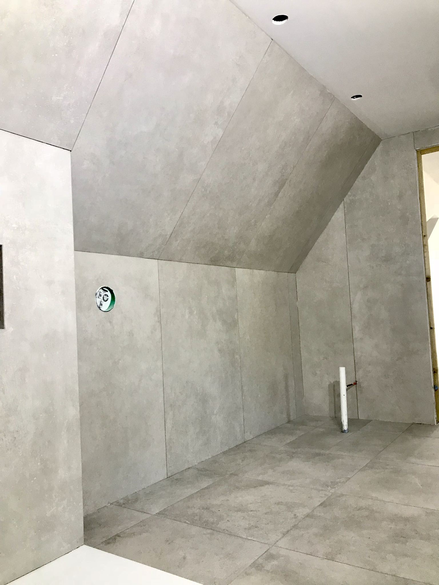

This is a floor I completed couple of weeks ago along with the help of @Mark Frost

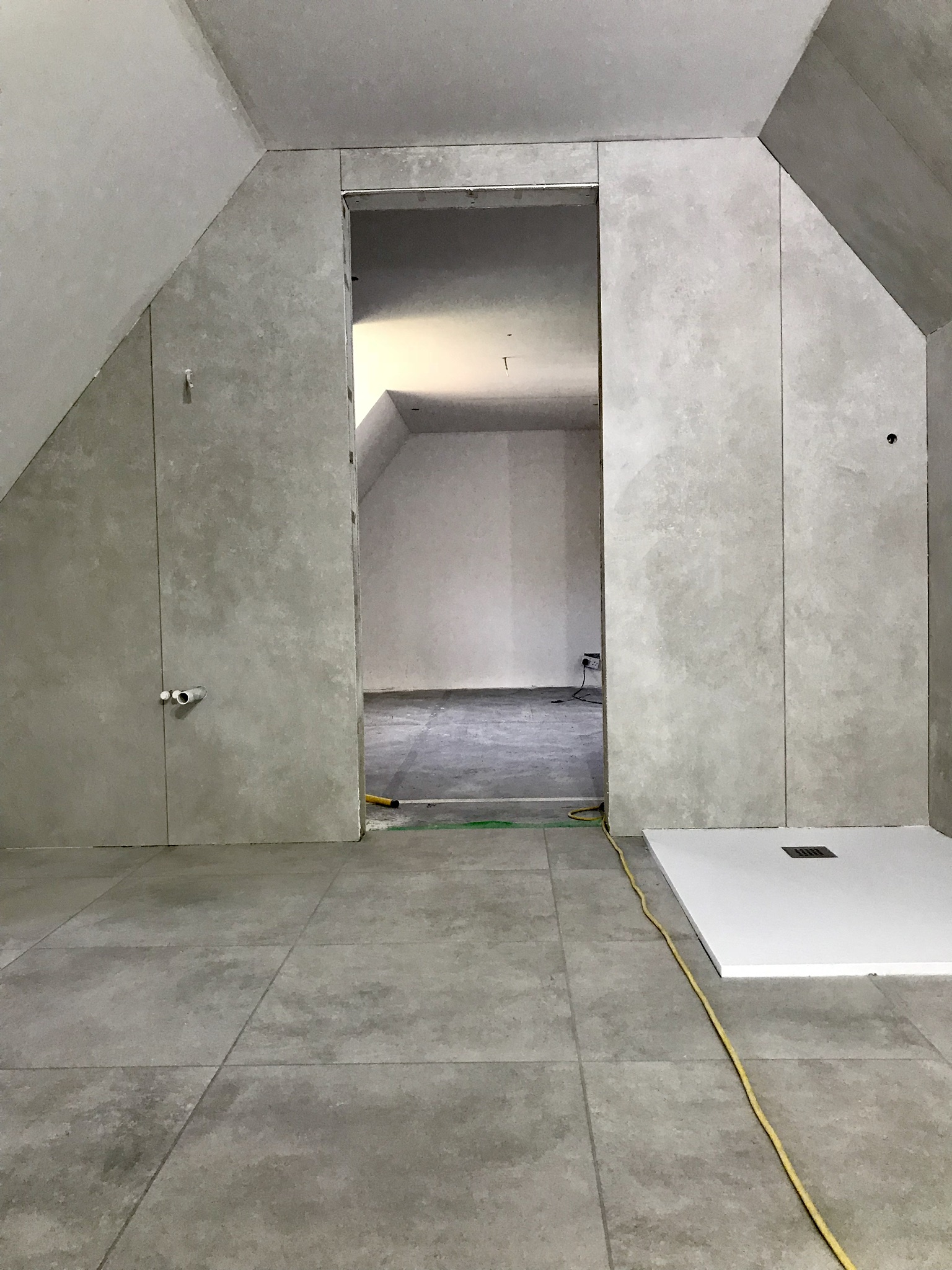

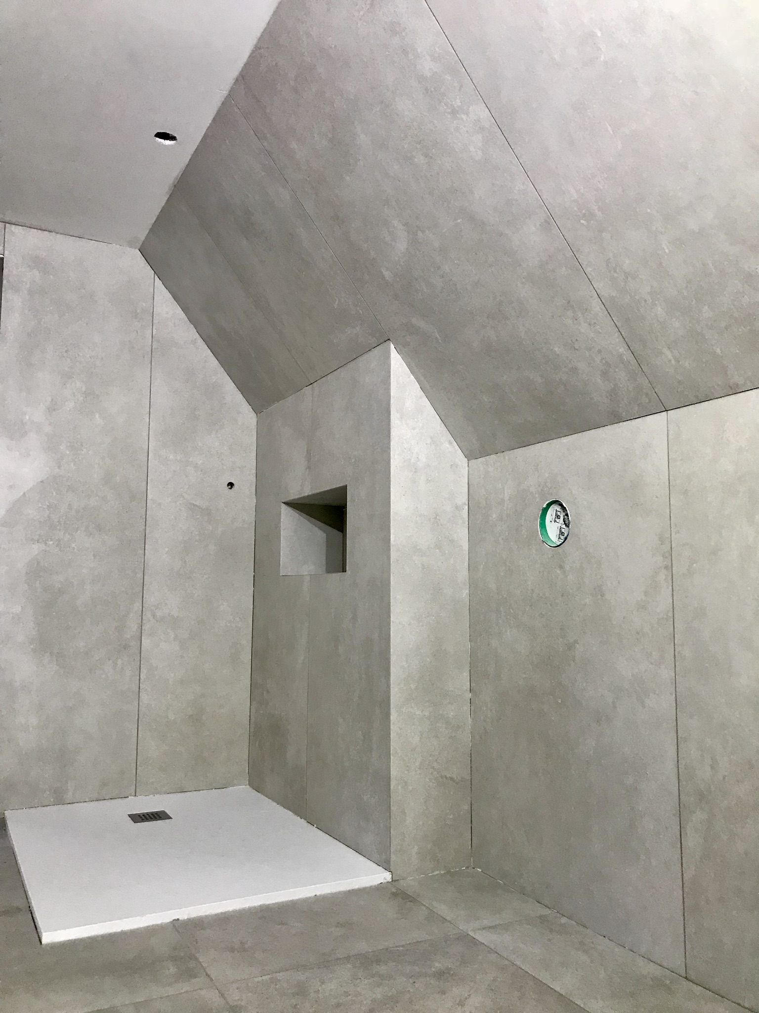

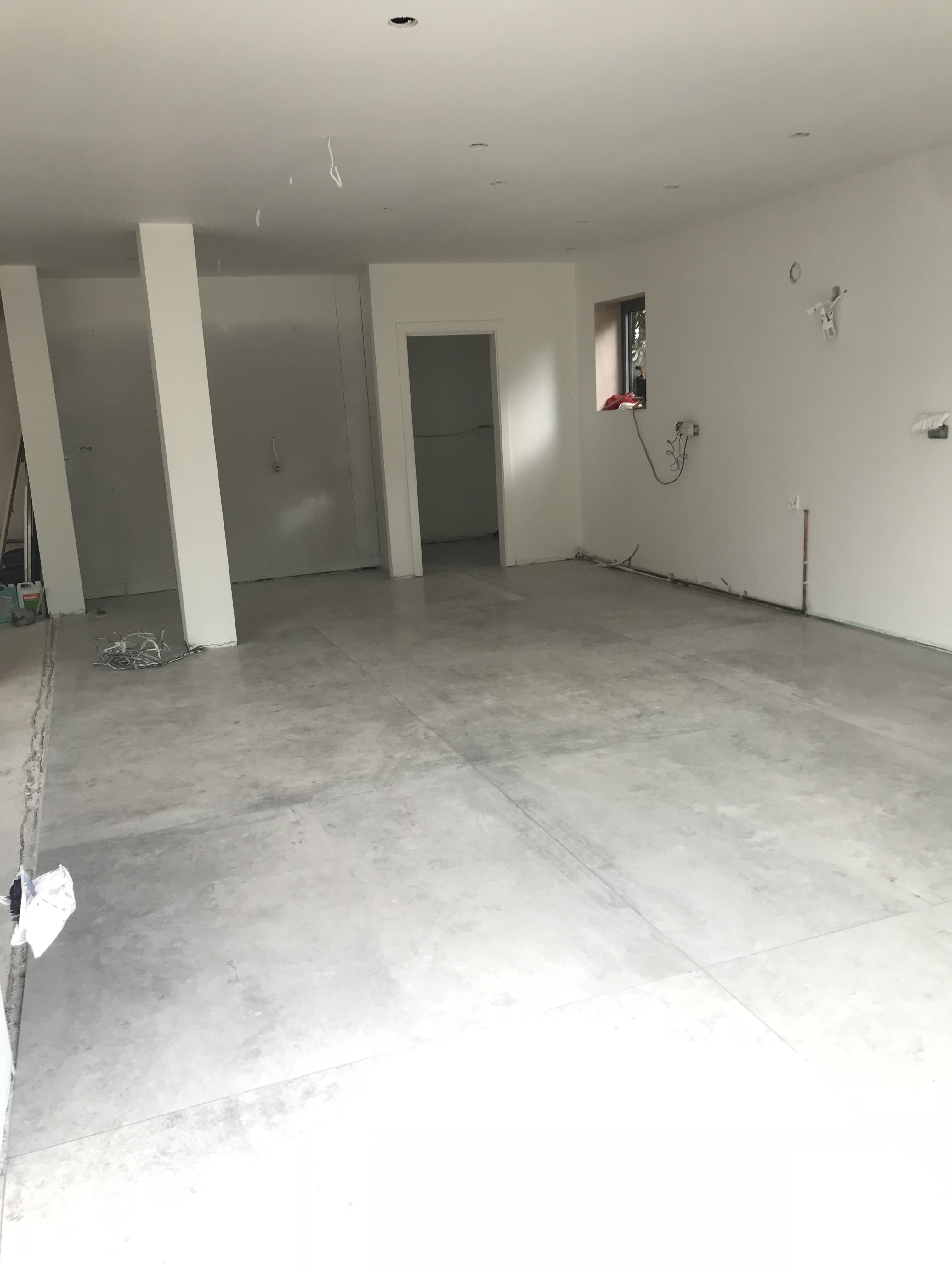

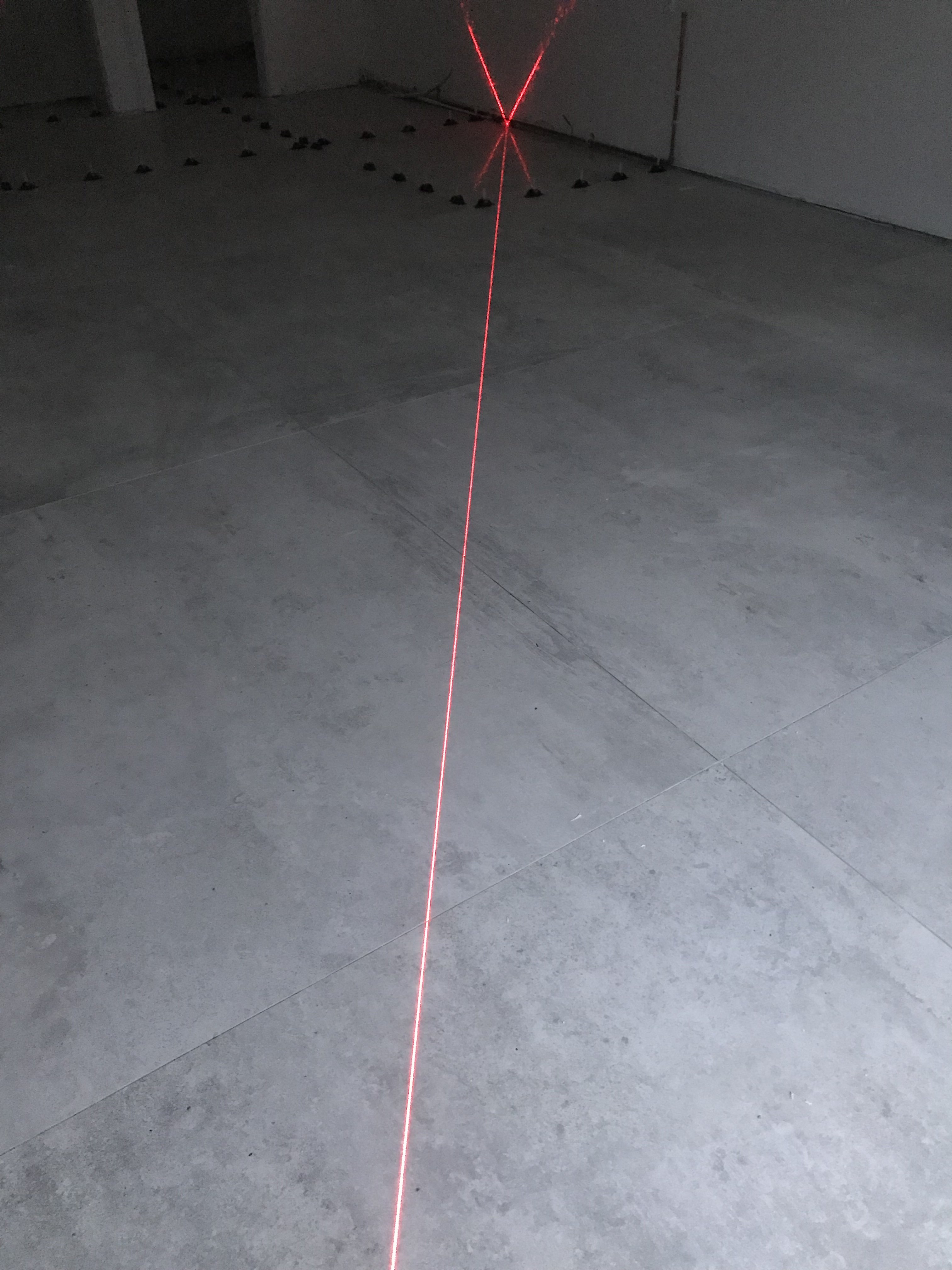

As title 1600 x 1600 x 6mm Florim concrete effect.
On sanded and primed anhydride screed, which was moisture tested twice over a period of 3 weeks.
Tilemaster Antifracture Mat installed with Anhyfix, and tiles fixed with Isomat’s AK25 S2 adhesive.
If anyone is interested, there are 5 pieces left over that the client wishes to sell.
Serious enquiries only please, whilst I’m sure you’ll get a bargain, it won’t be a cheap bargain. :D PM me for details.

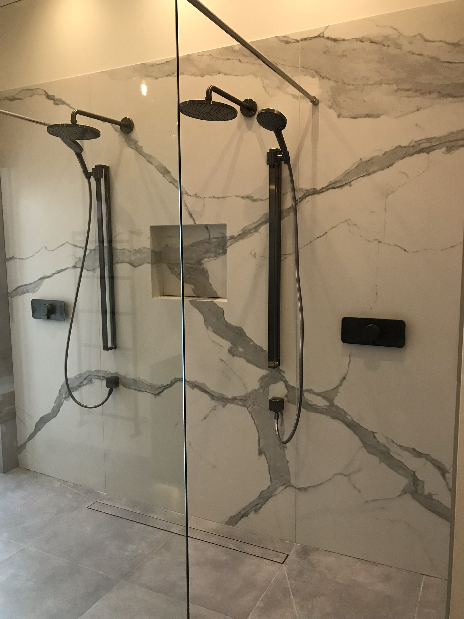

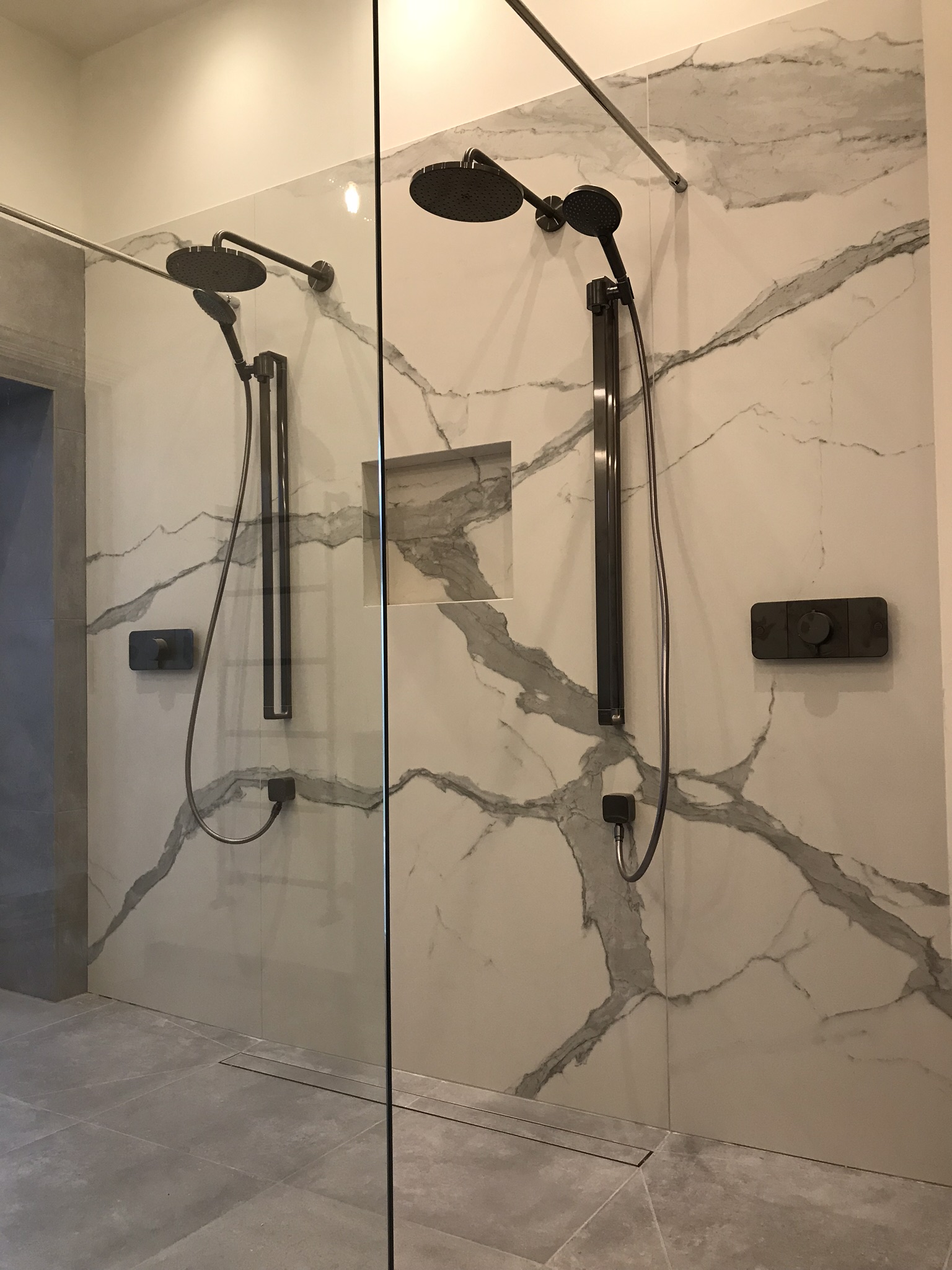

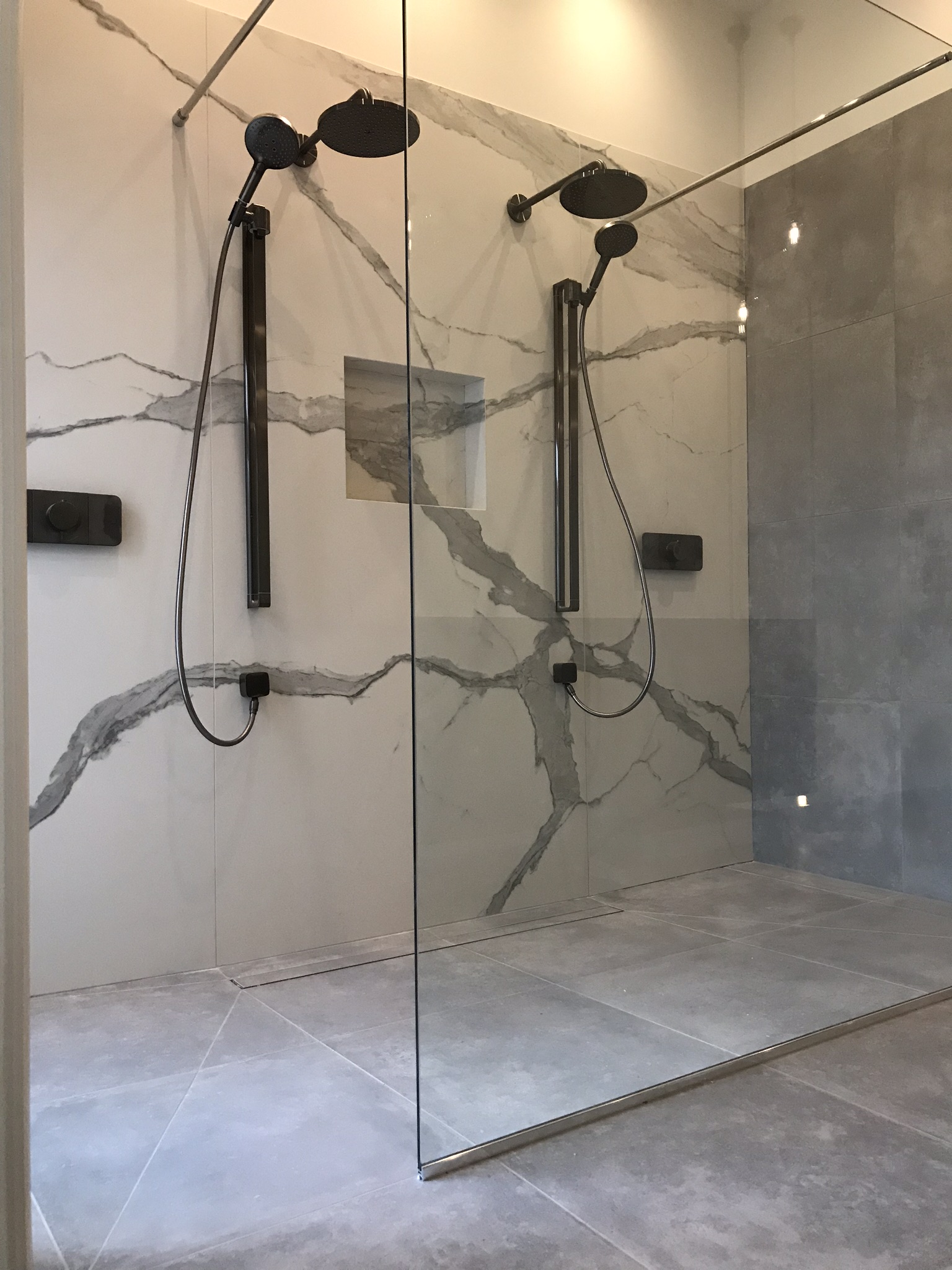

I actually plucked up the courage to use my Bosch GSL 2 on it afterward :) quietly pleased about the result.

I'm supprised at that with it being rapid set.
I never use rapid set on thin tile, by the time you’ve mixed it and applied to both surfaces it’s already going off and you can’t get the movement in the tile to bed it in properly in my opinion.
AK25 is not a rapid setting S2 by our standards. It has a comfortable 3 hr pot life, the same as their 2 part MegaRapid, which is an excellent adhesive too.
