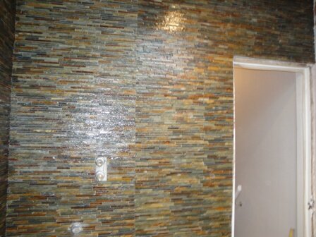

I know the blu tac company, and have used these mosaics I think, is this the one Neale?
