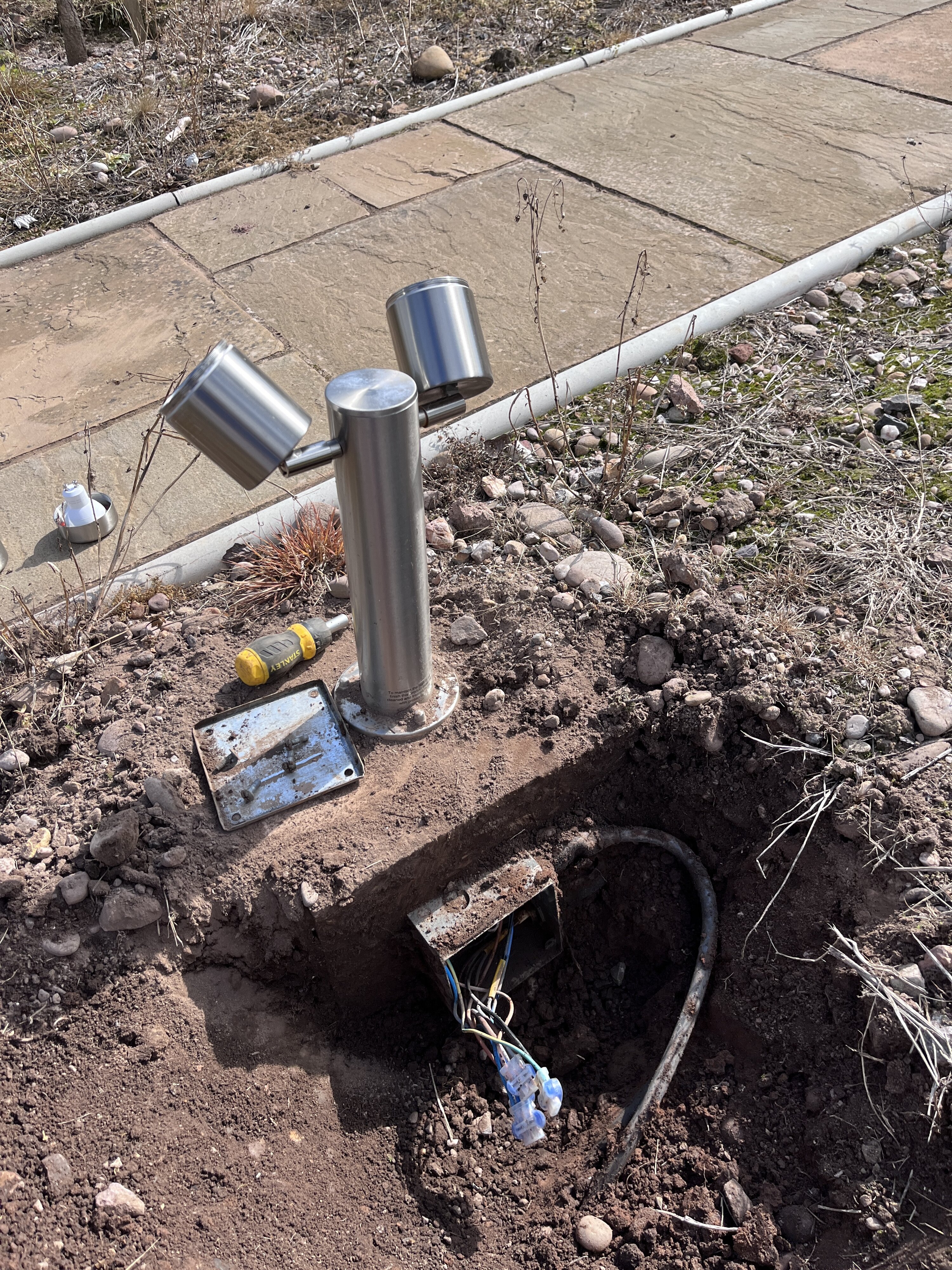

Just seeing what you all use use for buried garden light connections, to seal up fully from the elements/ vermin?
Been using 3M gel connectors for a while without any issues.
https://multimedia.3m.com/mws/media/1983303O/3m-scotchlok-idc-connector-314-datasheet-en-eu.pdf?&fn=EMD_EMEA_Scotchlok-IDC-Connector-314_TDS_AABBDD51044_EN03_R2.pdf
Just been back to check on a job (tripping out) and looks like the gel has been eaten from inside the connectors.
Quite a few dead suspect ants šŸœ had found there way into our galvanised box !!
Have seen the wiska pourable gel, anyone use this ?
