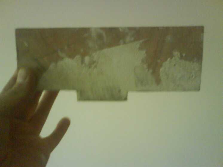

bigneil
I use a piece of wood notch out the ends which will give a depth gauge, Put addy on the wall and run gauge, The notch end on the tiles run along the tiles which should give you a smooth transition on the addy. Hope you can understand this
Me too, i solved exact same problem on walls and floors, in fact i still have the wooden thingy from last time kicking about in a dark corner of the van........TA DA
