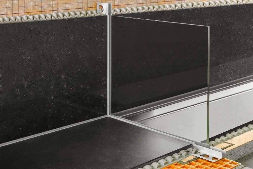

Unsure if I've misinterpreted your needs but what about something like the Schluter Deco SG - Schlüter®-DECO-SG | Function | Schlüter-Systems - https://www.schluter.co.uk/deco-sg.aspx this could coincide with the wall and floor tiling to allow a channel for the glass panel to be fixed in?
That's an excellent idea for the "freestanding" screen , thankyou, although I might only use the wall channel; I would be afraid of water making its way into the floor channel and stagnating. I will probably silicone the bottom of the screen directly on to the floor tiles. The main question was about fixing the glass wall panels to the tile backer board (Marmox). Marmox say silicone can't be used on their boards.
