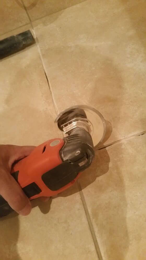

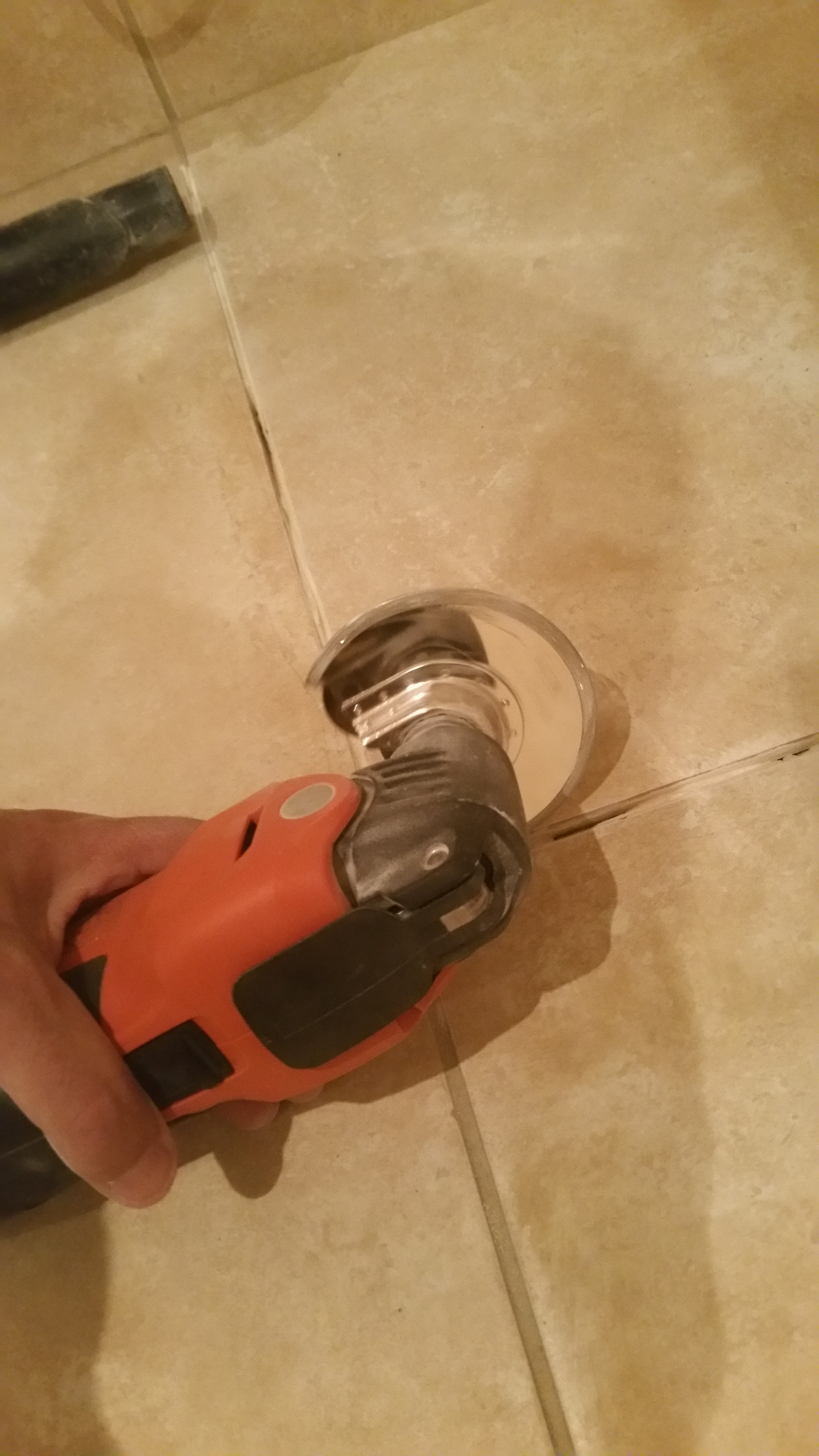

Great tool the Fein - I also use the diamond blades from Saxton too. I also use mine for cutting metal trims as it gives a really neat and quick cut ( with a metal cutting blade on of course!) One thing I like about it is the 5 metre long cable it comes with - very sensible
