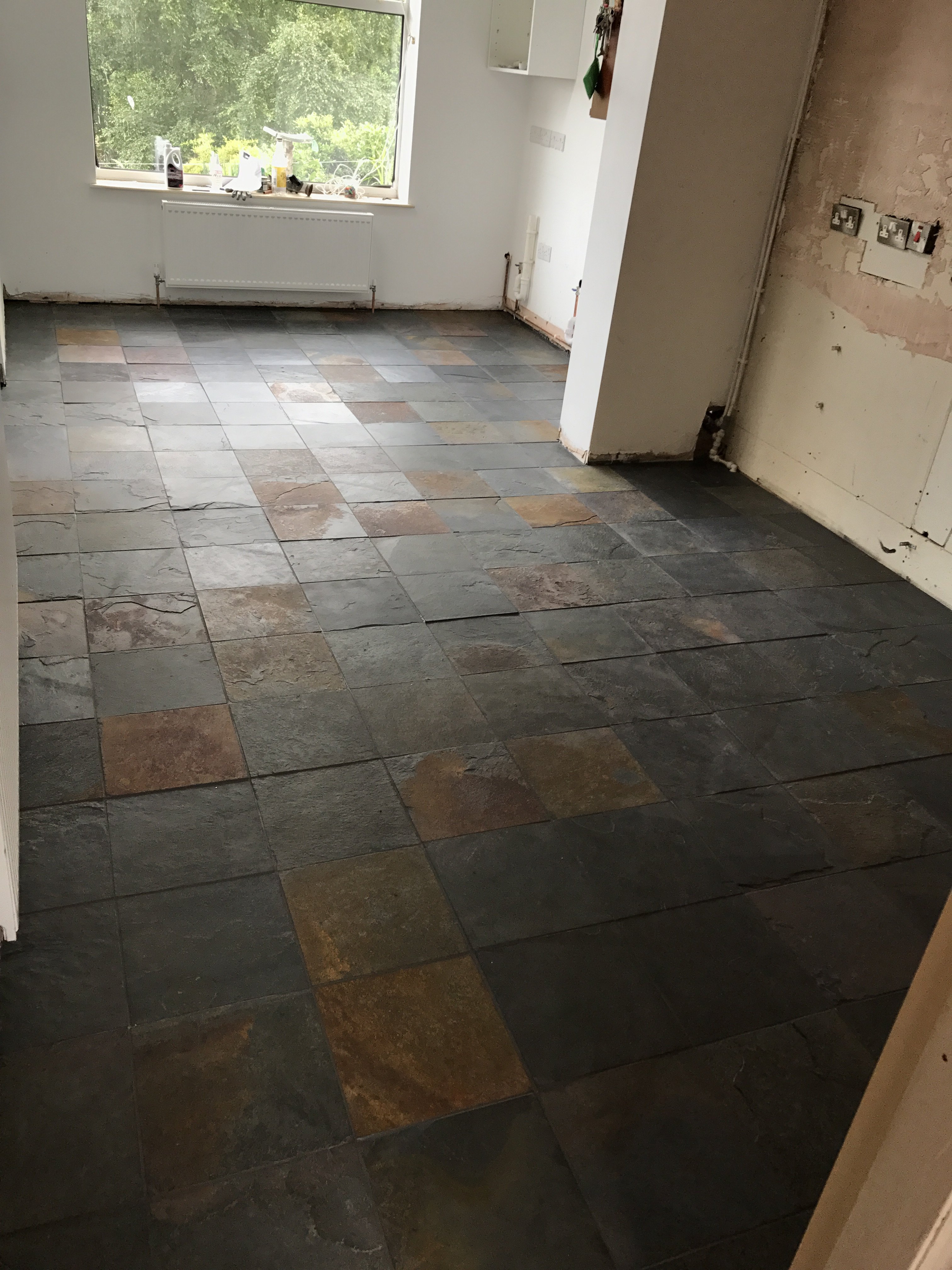

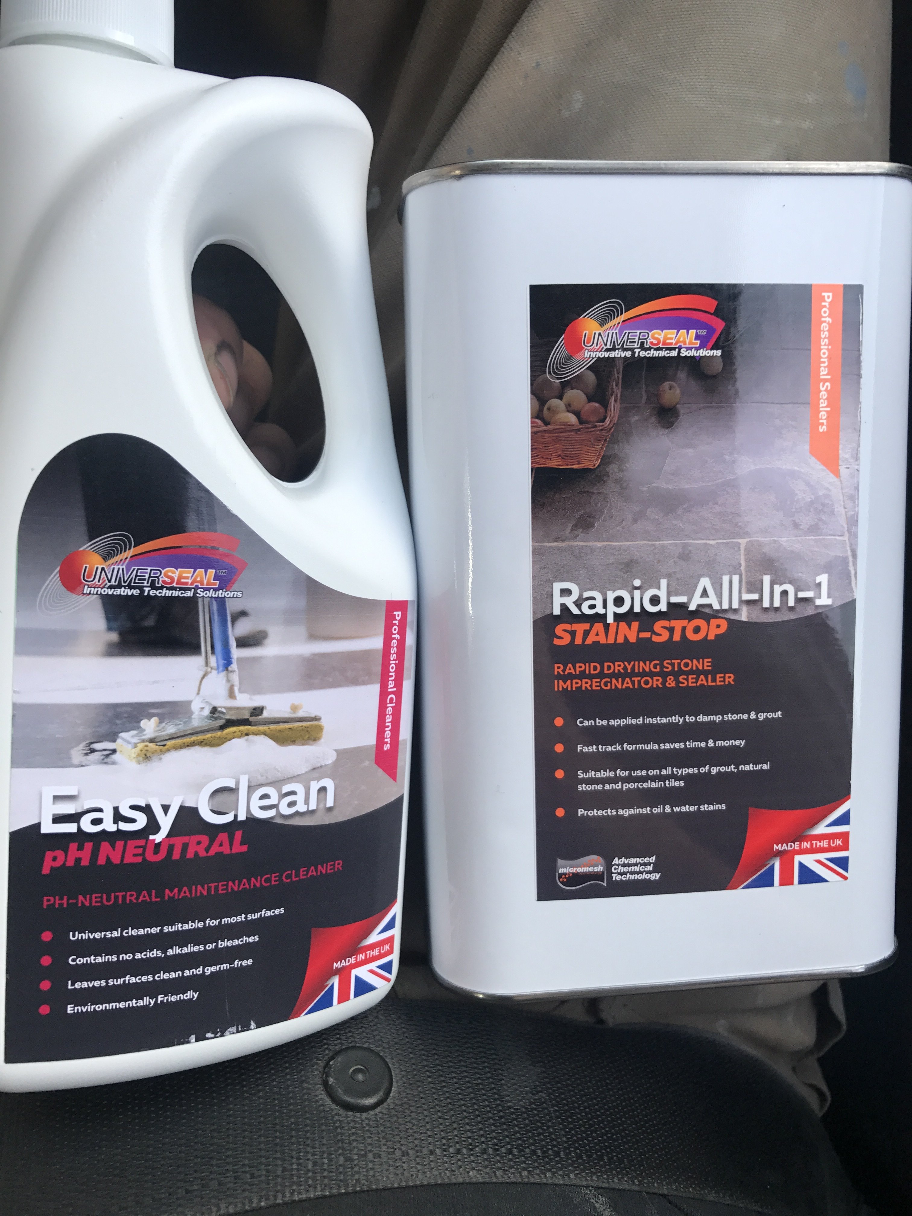

I take that to mean the surface is dry but the stone could be dampWhat I don't get with this product it says to keep floor free from water upto 24hours after application. It also says apply to damp stone but else where it says make sure stone is dry .their seems to be conflicting evidence on their website .
But what about grouting when it says to keep free from water for 24 hours that seems to be why people buy it seal grout seal all in a dayI take that to mean the surface is dry but the stone could be damp
Mate don't get me wrong I'm not having a go and I know others on here have done what you've done but why does their literature not read the same as their verbal recommendations. Obviously not an answer I expect anybody outside of universeal to knowI spoke to the tech bloke and what I did was what he recommended.
