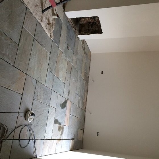

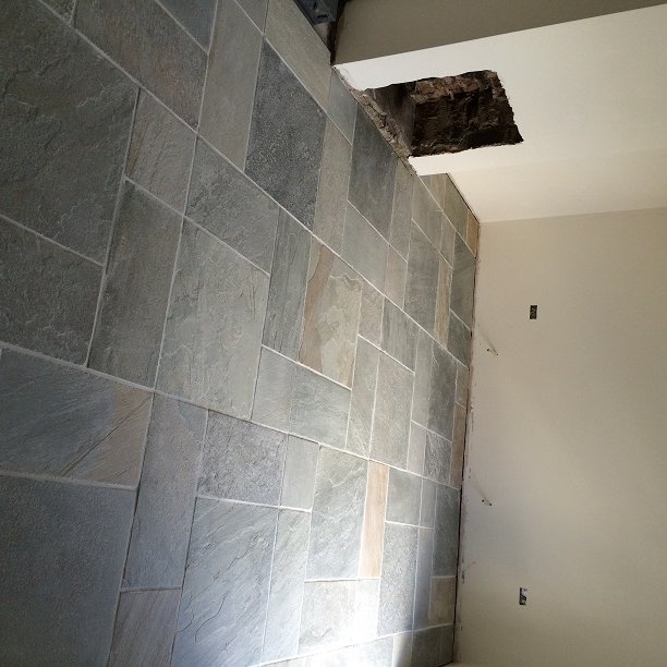

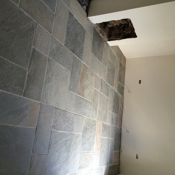

Hi, I'm not a pro tiler but am hoping to get a bit of advice from those who are. I'm laying about 40 sqm of oyster slate floor tiles starting with a shower room and extending into the kitchen / diner. The tradition float method of grouting would be impossible to clean up given the rough surface so I'm going to use either a grout bag or mortar / grout gun. Before doing so I have a few questions.
1. Are the guns better than a bag (I've not used either before)? I've read some good and some terrible reviews on the guns.
2. After piping the joints how long do you leave the grout before smoothing the joint? I've seen a you tube vid where the guy wipes the joint with a sponge straight after piping in the grout which seems to smear the grout over the face of the tile.
3. Whats the best way of smoothing the joint
Sort of related, the shower room is a wet area. I've installed a wet deck and tanked the whole room (screed floor). Should I use silicone in the envelope cuts and to seal in the drain or just grout the joints like the rest?
