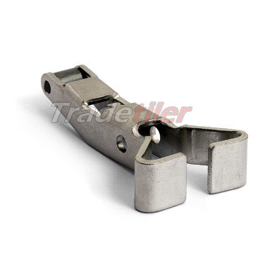

On thick tough porcelain I have know it possible to accidentally deform the top fork slightly buy pulling the breaking handle very hard. The geometry of the breaker is effected causing problems snapping even standard ceramics afterwards.
We supply spare top fork or the whole breaker on our web site here (links below)
Top Fork - http://www.tradetiler.com/rubi-fork-part-for-plus-breaker.html
