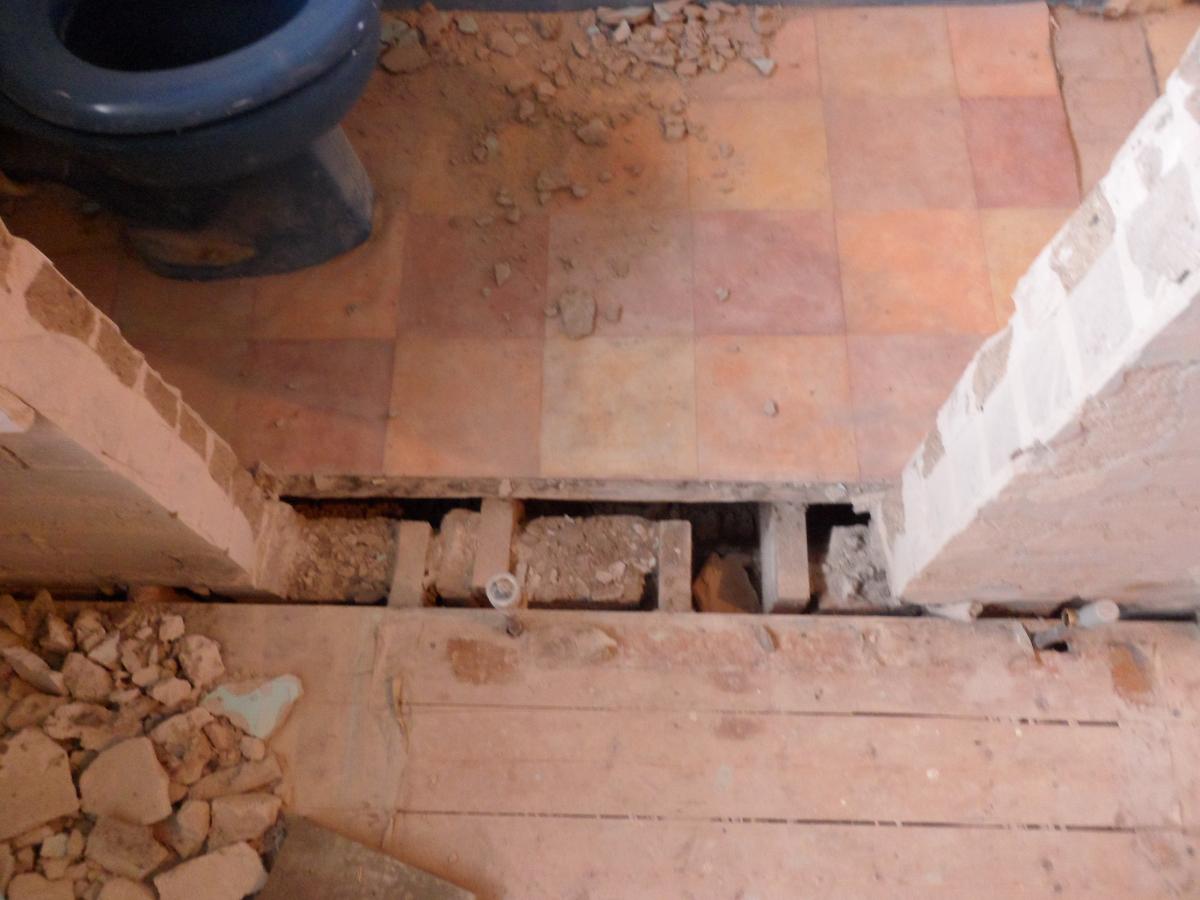

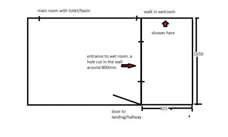

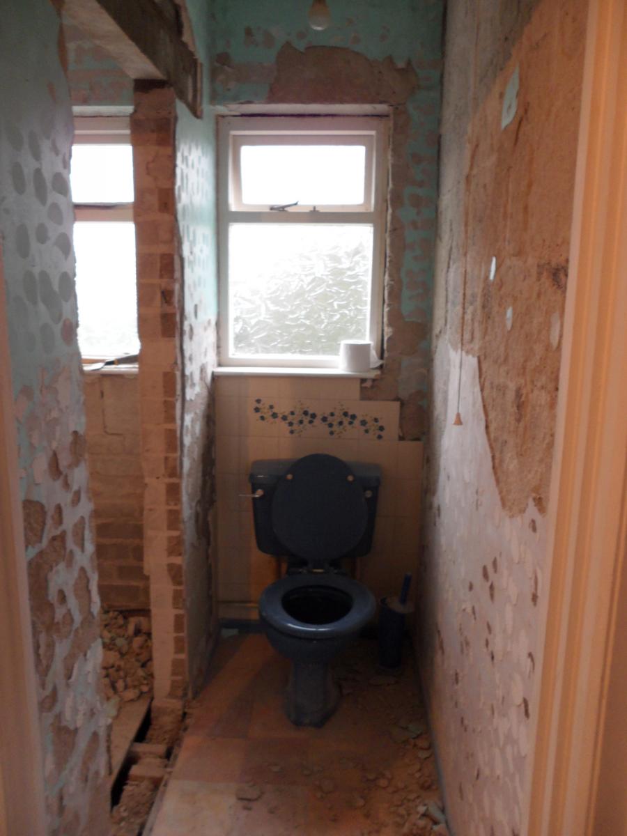

Hi sorry for the delay, couldnt find the usb for the cam. anyway here are the pics i took today and also a silly design i worked up in paint.
so as you can see its a odd shaped room, i had 2 ideas in mind but im not sure about 1, first i was gona use marmot backer boards over the whole room and for the floor i was thinking id use wb ply cut to fit and put straight on the joist's. but at the back of the room raise the joist's by 10mm (this enough for a fall?) and put extra ones beside them while falling to the shower end with a gulley drain the whole length of the back wall. how does this sound?
number 2 came from what all you guys said, i buy a Marmox Showerlay Former either 1000x1000 or 1300x800 and cut them to fit the shower end and use the backer boards to tank the rest of the room.
now im stuck here, the hole i cut in the wall, well i was gona put a step in there maybe 2 brick high so the shower room is like its own little space, but my gf's dad said this might look silly and should just be floor level all the way through. any thoughts on this?
wetroom2.jpg as you can see its a very small seprate room, the door from where the pic was took will be blocked up as will the window, the shower will be where the window/toilet is now, with the entrance to the left there room is 825x1650mm.
wetroomstep.jpg should i build a step here or leave it flat? i think a step would make the room easier to tank?
anyway let me know what you think :) thanks for all the info so far. i will be using these phg guy. gona go check if they deliver to northern ireland now
